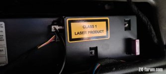

Help....Which bluetooth pairing device do I need for streaming music from android in my 2003 Z4 E85
@AshP here you are. picture looks like a mess but again, it's quite straightforward

That's great, thanks for taking the time to dig the photo out for me. I will go ahead and order both units and let you know how I get on in due course.NaweedMustafa wrote: ↑Mon Sep 18, 2023 7:35 pm @AshP here you are. picture looks like a mess but again, it's quite straightforward

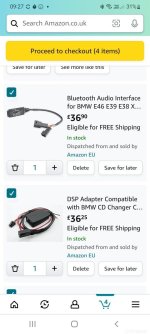

Hi again, sorry for all the questions. I'm new to this kind of thing and this will be my first attempt at audio electrics, if you can call it thatNaweedMustafa wrote: ↑Mon Sep 18, 2023 7:35 pm @AshP here you are. picture looks like a mess but again, it's quite straightforward
I'm about to order the following. See photos below: Is this all I need? I take it you used the i'bus to connect the dsp to the 12v and ground lines on the blue music device? Please can you share which one you used as I'm not sure what to order. Is there anything else I will need to purchase to complete the job?

This is correct. Also get some clip in wire taps to tap into Voltage and Ground. The 3 pin connector is your Voltage, Ground and i-bus. Not sure which order but I used a multimeter to verify which line was voltage and ground. You of course don't tap into the i-bus wire as you only need power for the dsp module

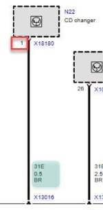

Double check with a multimeter, wires on pin 2 and 1 should be your V+ and GND. Pin 1 is K-bus (not i-bus, my bad)

That's great, thanks for sharing the wiring diagrams. Very helpful.
