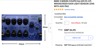

Second, did BMW make the exact same lens but with different model numbers for the Mini, 3 Series/E46, E85/86, etc? On this particular Ebay store, they have the exact same picture for each of these different cars.

Here's the Ebay store selling two "different" models:
- Screen Shot 2023-06-06 at 8.29.23 AM.png (227.56 KiB) Viewed 195 times
- Screen Shot 2023-06-06 at 8.30.23 AM.png (232.18 KiB) Viewed 195 times
