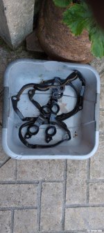

Zedshed Cymru visitor today 2.5 with Andy from Cardiff small leak of oil onto exhaust failed gasket. Old ones early signs of going hard hence the leak. Replaced and quick look at the underside whilst on the lift, good nick under there and pristine on top. New discs and pads planned for next visit plus oil and filter change. Andy lucky to find such a nice car it's been looked after by previous owners.
