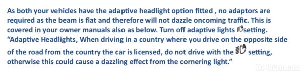

Yes I did this when I imported my UK car into Spain. However if you are only on holiday there is no need to do anything. BMW UK told me that the E89 has a flat beam pattern and does not need adjusting to drive on the right. I think they are correct as having driven through France and Spain at night I never once had any problems.
The problem came when I was trying to register the car onto Spanish plates and the ITV (MOT) centre I took it to said that according to their machine the headlights were ever so slightly pointing to the left and I needed to change them. That is when I managed to find the switch, saying that I have since switched them back to drive on the left because in the previous setting the left side of the main beam was badly cut off.
I now take the car to a different ITV centre and have left the lights adjusted for the UK but have passed the test each time without any problems.

Yes you have to change both sides. To get to the switch it's a case of taking the wheels off and accessing the the back of the headlights and remove the xenon bulb too and then you will be able to see an arched shaped lever.

No switches or levers on E89 lights.(I believe so on the E85).
I have had them apart.
The shutter has a step to blank out the other side of the road.
The are handed for L or R drive cars.
Look directly into lamp you will see the shutter.

I assume the E85 has xenon, one for main, one for dip. So dip reflector could be rotated to offset the beam.
E89 has HID projector.
