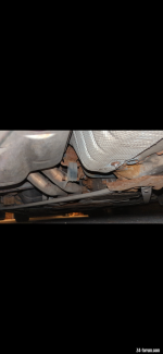

Underneath the car I can see one exhaust silencer hanger (I think that's what it is) and the exhaust generally feels really solid if I try and move it a bit at the end. Everything I can get my hands on under the car feels really solid (albeit a bit rusty, but that's to be expected at 11 years old, right?)
As I said, one new spring a week ago and the other rear spring was replaced not too long back before I purchased. Although, knowing what a broken spring sounds like, it's not that.

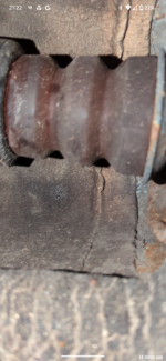

I had this when i bought my car. (BMW were a waste of time, yet it was an old BMW bulletin that gave a solution).
Took 6 months to solve.
I removed the rear spring on the right, washed the rubbers top and bottom.
Covered them in talc. Refitted and i rotating spring on fitting by 45 degrees anti clockwise.
The sound, like a rubber mallet hitting underside of boot went away.
I believe the barrel springs pinch the rubbers and rebound causes the knock.

One thing which sounds plausible is the suggestion that the newly fitted barrel springs pinch the rubbers and this rebounding causes a knock - that the springs need rotating by 45 degrees. Would there be any tell tale visual signs of this pinching that I can see without taking the wheel off? Would I expect to see some kind of rubbing away of the black paint of the spring?
I didn't notice this 'underside of boot being hit by a rubber mallet' noise (as someone so accurately put it!) before the spring was replaced. Trying to decide whether a) I didn't notice because the snapped spring was masking the noise, b) the replaced spring fitting is causing the issue, c) that something else has gone kaput since having the spring replaced and it's no coincidence at all!
