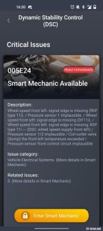

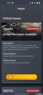

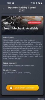

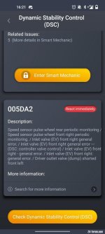

So, here's an update after running the code reader on it.
Seems to be the speed sensor, and not the ABS sensor. Would I be right in assuming that?
Although the lights have since gone out..?

- enuff_zed
- Posts: 14759
4 warning lights popped up
Looking at what you have, there seem to be codes for various wheel sensors. However, we don't know how long they've all been there.Dr. Zed wrote: ↑Sat Mar 18, 2023 9:34 amI've cleared the codes too and haven't come back since but still don't like the idea of it as it seems quite serious so I'm a little concerned still..healeyneil wrote: ↑Fri Mar 17, 2023 6:43 pm Funny enough, mine did exactly the same this morning. Plugged in my reader and it was the front nearside sensor too. Cleared the code an all seems well
I would suggest that until the fault happens again you won't be able to exactly determine which one it is.
Keep your code reader in the car and when it happens again immediately check the codes and hopefully that will give clearer indication.
Usually these kind of things fail a bit like a light bulb, as in, when you switch them on and off. That is why I asked whether you'd been through deep water or muddy roads as it seemed odd for it to happen mid-journey.
Keep watching it.
If it does occur again it means you won't have the DSC active, so just drive a little more cautiously round sharp bends, off roundabouts etc.
In effect, your Z4 becomes a Capri until you reset it
