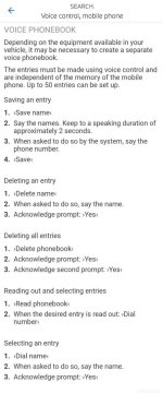

Yes to use Voice to dial a number it has to be entered manually.
BMW stopped supporting these cars for the entertainment systems, both iDrive and non-iDrive, in 2012 when they moved the 3 series onto the F series and the NBT iDrive as all cars were supplied with iDrive. So the E89 was left with the outdated CIC for iDrive and the old standard radio. So it is an old system, 11 years at best.

From my owners manual I have on my phone (app called BMW Drivers Guide on Apple send Android)....
- Screenshot_20230313_173901_DRIVERS GUIDE.jpg (76.58 KiB) Viewed 99 times
