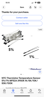

The heat sensor is effectively a thermistor which senses if the seat gets too hot and cuts off
You can install a thermistor (I will check the spec) into the circuit and bury it in the seat to do the same job
It connects onto the supply wire and earth- I’ll share a thread where I installed heated seats into a non loom present car which will help explain
