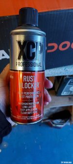

I like this , Peter, spray on,
- 20230118_162051.jpg (93.01 KiB) Viewed 270 times
