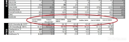

Had a string of high lead readings on oil analysis since ~22k miles. Attached is the oil analysis back in 2018 right before I did my rod bearings.
- MCoupe_Oil_Analysis.jpg (232.42 KiB) Viewed 523 times

Can you get oil analysis in the UK? Seems very much a USA thing

Not really, lots of places in europe.
For the uk Millers is popular.
https://www.millersoils.co.uk/oil-analysis/

Thanks for posting. If I get another S54 that is great data to have.
