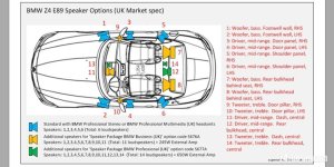

2009 E89 with the base 6-spesker audio system.
I want to add speakers to the system where the top-hifi speakers would be.
Does anyone know if the speaker wiring harness for these missing speakers is in place? Perhaps tucked away in the empty cavities?
Does the base audio system have the full speaker wiring harness?
Not usually...certainly specfically the connectors for the amp are missing and also the 676 and 677 amps ahve completely different connectors..you didn't make it clear which of the missing 8 speakers you were referring too?
I have the blue speakers in the attached file.
I want to add the green and yellow ones.
Well 12 and 14 defintely doesn't exist wiring wise..I doubt that 7 and 8 do as they require a lot of extra bits and are a bitch to get too..9 and 10 piggy back of 3 and 4 so they are easy..as for 11 and 13 ..pass..
IMHO your first call would be to get decent speakers for the first 6 speakers they are sh1te..these days lots of plug n play options for them , I think the woofers 1 and 2 are still handcrafted upgrades generally..
see this.. viewtopic.php?t=116918
