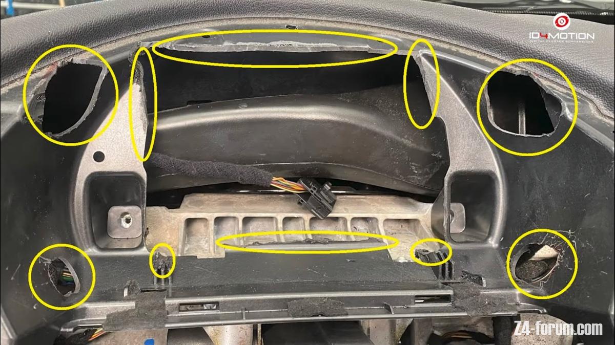

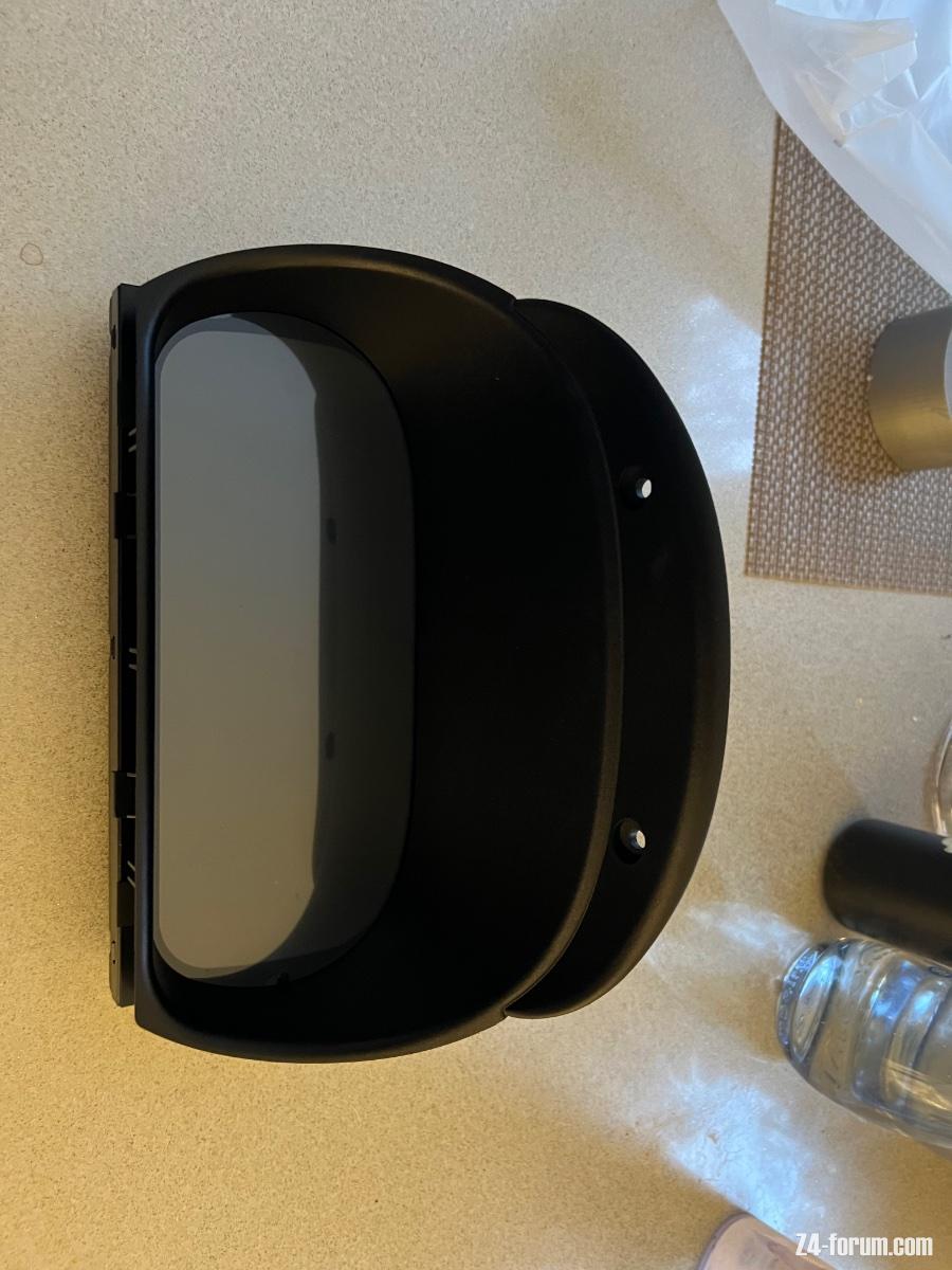

I wanted to update everyone on this Chinese made digital dash.
I received it last week, I won’t go into huge detail here as I am trying to do some in depth testing and will put up a separate thread with my findings later, but in short:
1. The E9X version works straight out of the box in the E89. In that it really is plug and play - most (if not all) the functions I have tested so far seem to be reflected on the dash - but that’s not an exhaustive test at this stage, I’ll update that later.
2. The plastic shroud you get with the screen fits the E89 dash space PERFECTLY- its like it’s made to measure.
3. However, the screen does not go into the dash w/o needing to alter the inside plastic first. This is no different to the ID4Motion screen from the US - I would argue that this version will need less “alterations” as the US screen is perfectly rectangular whereas this Chinese version has the corners notched out.
4. I’m happy to make the alterations as long as a) they are not visible after the fact and b) I can put the “old” cluster in with no problems. It appears though that this is achievable (going on what ID4Motion say about their screen). I am doing this slowly so that I only remove the bare minimum needed - documenting as I go. (Cold weather is hampering efforts though as I’m working outside and it’s bloody freezing here!!)
5. I’ve managed to exchange quite a few messages with a sales person in China for this device - they are obviously keen to know this will work with E89 and I have already supplied them with (for example) images of E89 vehicles that could be integrated into the library of cars they use. I have also pointed out various spelling mistakes and pointed out the need for a “British English” language option as we don’t like using “tire” and “color” etc :)
6. I’ve paid regular price for this device and am not getting any kickbacks - but the guy in China is keen to point out that a group buy is more likely to result in changes being made as money talks!
7. I’m also following the route of looking at how “hackable” the device is - so that we could make changes w/o need to resort to our Chinese friends! In short it looks promising! It’s an embedded Linux product using the QT platform to produce the UI. There is a usb port that is used to enact an update on the device and that might be a route into the device. There is also a connector on the device that I am 99% sure is a UART (serial connection) which I am actively probing now, if successful this would provide another route into the system to make changes.
That’s all for now - feel free to ask any questions and I’ll answer them if I know the answer and if I need to test something I will if I can.
In the meantime I am continuing to try and get the screen to fit and attempting to gain access to the system.

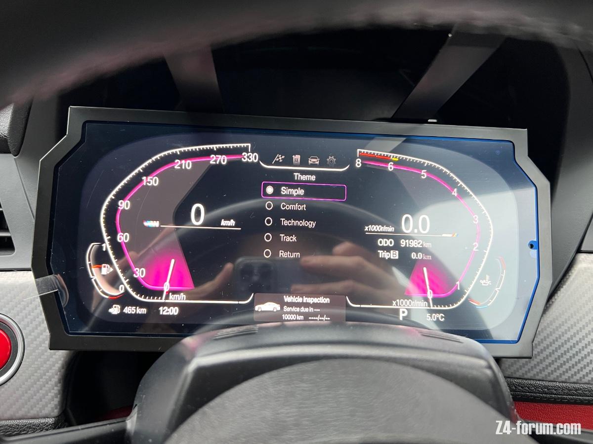

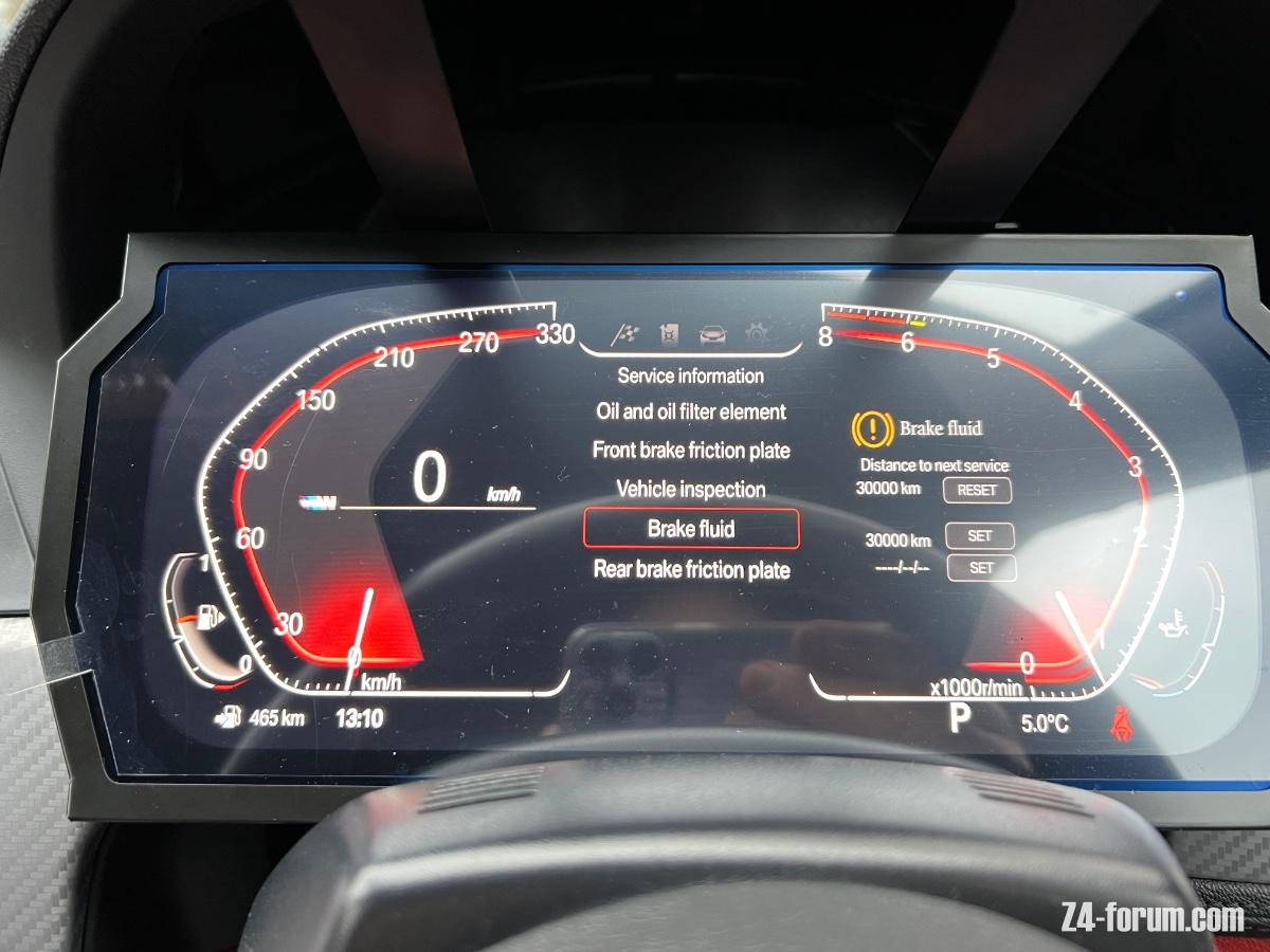

AnubisZed wrote: Sat Nov 12, 2022 10:39 am OK so I know it's been brought up before about replacing the current cluster with a digital version and the ID4Motion one has been posted here, along with it's hefty £1000 price tag, well we'll soon have access to a cheaper version that'll do, almost, the same thing.
So although it's not for the E89 cluster I've posted a photo of what one will look like (E89 version still in development at the moment). As you can see it has the ultra-modern BMW digital style to it and not a digital analogue look like the ID4Motion one (the modern style is available at more expense from ID4Motion!).
Price should be around $600 to $700, but is it something you'd like?
Oh and just for the techy's, it's NOT Android based but is using the Linux platform.
