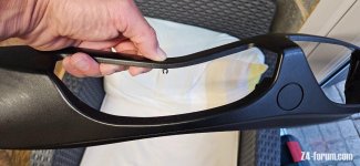

The manual seat has an extra clip where my thumb is which you prise up with a flat screw driver:

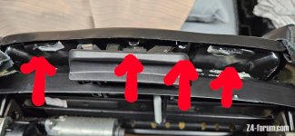

Tip the seat back so you can see the underneath.
Have the thigh support fully out. My photos show the leather already already released but should guide you in the right direction.
The four arrows point to four metal tabs you will have to bend away from the leather trim. Use a big flat head and a medium size flat head.

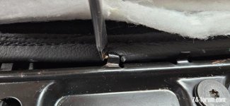

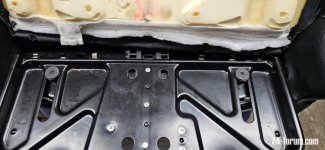

Prise out the leather trim all the way round and lift it up you'll see this:
Use a medium size screwdriver to push down and if needed a small screwdriver to push away to release. There are four. The foam and leather should now be free to come off.
