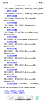

- paddy wright
- Posts: 7664
- Location: south yorkshire
Can I use airbag modules from 6/7 series with same part no?
Check on real oem- it generally lists all applications of a part number
- paddy wright
- Posts: 7664
- paddy wright
- Posts: 7664
Checked for you- yep listed for both cars so all good
- F13587C2-5867-45F7-AA43-B24E476E2745.png (250.77 KiB) Viewed 413 times
