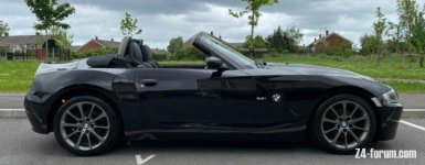

Thanks, I have these if that helps...

That looks like a style 200 8” wheel with et46 offset. In which case the outer face of the wheel at the back is in almost exactly the same place as the standard staggered fitment 8.5” et50. If so, a 15mm spacer is bang on the money, 20mm is too big and protrudes outside of the wheel arch.
I’ve not tried spacers on the front but they don’t need as much as the rear. 10mm would probably be best.

Yes, they are style 200's. Thank you for the advice. I thought 20 might be a touch too far. 10mm front and 15mm back it is then.
