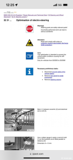

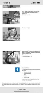

Somewhere in there I did the EPS adjustment outlined here
This made a huge difference and I can’t recommend it highly enough. The trick is to rotate the bottom of the ring toward the driver to loosen it.
