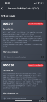

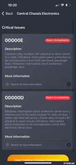

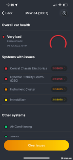

ABS and Traction control triangle lights have been totally wiped. Lights do not come on when ignition is turned on.
DTC button does not do anything at all either. Same with TPMS button

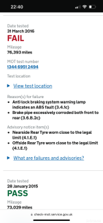

Brake pipe corrosion can be hidden by smothering in copper grease ( no photo ) or tape ( see photo) TBF my first thought was maybe they had it stuck to a cable rod fishing tool to feed it through the back end of he car. But the tape looks brand new compared to the pipe Exhausts can blow especially in 4 places

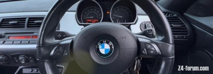

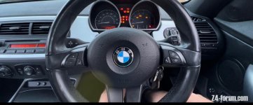

When buying cars from dealers you would think they would be valeted or at least sanitised especially after Covid-19. Quick wipe with baby wipes on just the steering wheel showed all of the below. Continued wiping down the rest of interior and it was yellow. Cars are sometimes smoked in I suppose.
