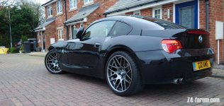

Here's mine with 19's after I picked it up from the powdercoaters
- DSC_0367.JPG (153.23 KiB) Viewed 1122 times
- DSC_0365.JPG (161.9 KiB) Viewed 1122 times
- Snapchat-1318207064.jpg (129.16 KiB) Viewed 1122 times
