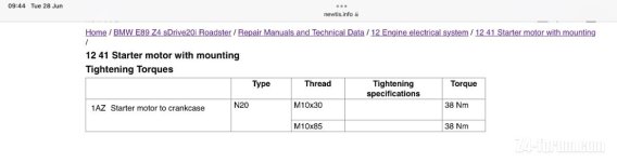

I downloaded 'BMW Z4 2.8i3.0i3.5i3.5is 2009-2016 Workshop Repair & Service Manual.pdf' and it says to replace aluminum bolts and table 12 41 states a torque of 38 Nm. When I tried to install new aluminum bolts, the bolt snapped before I reached the target torque. I checked the calibration of my torque wrench and it is accurate. Is 38 Nm for steel bolts and there is a different spec for the aluminum bolts?

The torque setting seems correct…can’t access real oem at the moment but would be surprised if those were aluminium alloy bolts…10mm not a lot of meat for such an application..?

Looks like the correct torque for the aluminum bolts are 20 Nm + 90 degrees for the short bolt, and + 180 degrees for the long bolt.
