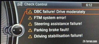

any idea what might be the cause of this error triggers simultaneously?
is there any module that control all this stuff together that might be defective?
can it be a battery problem?
the errors come and go from start to start
z4 e89 errors

No expert but how old is the battery, would be the first place to start and probably the cheapest

I was always getting Bosch dsc errors on the obd reader and recently ebrake voltage error.
Just replaced the battery, i need to go back and cancel these errors to see if battery has cured those problems.
I replaced with a Varta battery, about £130 ebay.
I registered with my obd reader.
Gives option for agm or std battery.
It asked for some numbers off battery, which i couldn't find, but looks like even BMW on the first battery didn't bother.
My old battery was Halfords Yuasa, with a 4 year guarantee, so one assumes these batteries good for 5 years. Mine was 6 years old.

Almost all those errors involve the DSC unit…
As others suggested status of the battery would be a good first move.
FWIW if there are no other errors showing on the code reader I thinks it more than a battery issue..but..try with a fully charged battery..

thanks for the answers , thats the battery info i can provide
- Screenshot_20220619-132709.jpg (89.26 KiB) Viewed 434 times
- 20220619_132204.jpg (139.3 KiB) Viewed 434 times

Could be a poor electrical connection at the ABS pump connector. Try reseating it. Remove the plug and then put it back on. It's a simple first step.

IMHO good first step…FWIW battery looks pretty healthy if the diagnostics are to be believed..

Hello
I had very similar symptoms
The reason was that rodents bitten the wires (marten)
