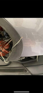

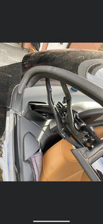

Sorry to hear you're having problems, it'll more than likely be a broken wire, I've had one on each side repaired so far after replacing the micro switches didn't repair the fault, the only way to be sure is to strip off a section loom tape near to where the wires fold and then give each one a pull, it's easy to fix once identified, you won't find the broken wire by simply looking at the loom you have to strip the tape back, hopefully the code reader will have identified which side has the problem.
Usually in this location
This was one of mine that connected to the rear clam microswitch
