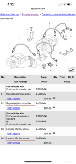

Hi all
Thought I’d got the right one but clearly didn’t
I need to replace my bank 2 lambda sensor- pictured
M54 2.5
Which one am I looking at on realoem please?

2 will be Bank2 pre cat sensor
4 will be post cat sensor
Note the cable lengths.

Below are the Bosch Sensor numbers for Bank 2
Sensor 1 (before act) BOSCH 15668
Sensor 2 (after cat) BOSCH 15669

Cheers lads
