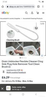

Just use a long sink drain cleaning brush to clear drain tube you can access from underside without removing anything other than the bung

I am going to leave the bungs in as they reduce road noise which I know is already pretty loud on a roadster. I know how to clean as like I said in the first post I was going to get a long handled bottle cleaner and poke it up the drain pipe. Exactly the same as the pic in post 2.
