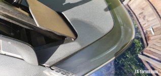

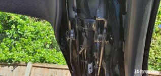

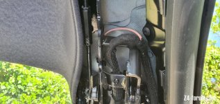

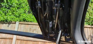

Some of you may remember that I had a problem with hydraulic fluid leaking, well the last couple days I have noticed it started again. I have had a look, and does not appear to be coming from the parts that were replaced last year.
About a week ago I did see a small little washer broken in the boot, I'm assuming this could be where it is coming from. Hopefully this is all it is, I have stopped using the roof until I get it sorted.
Hopefully I will get a local BMW specialist to have a look tommorow.

Those small plastic washers seem to break on multiple cars, but we didn't identify a problem based on this.
From my point of view, this broken washer does not correlate to the hydraulic issue. Where can the oil be seen on your pics?

Well a couple weeks went by, and it seems to have stopped - strange things these cars and their roof's havent seen any more fluid leaking and the motor still has fluid in there which i check everytime before i use the roof, fingers crossed it's ok.
