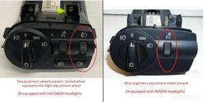

3. One internal (cabin) indication of having xenon is the LCM. The LCM is the Light Control Module. So I’ve included the visual differences of the LCM. There are variants of the LCM with/without the auto headlight function. So ignore this, essentially what you’re looking for is the two adjuster wheels. One is for the brightness of your dashboard. The second wheel is for headlight height adjustment, which is only possible on the Halogen.
