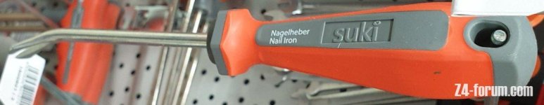

Thinking about this task again, I'm not sure if you will be able to get it solved as written above. It might be much more complex to drive the roof in this irregular situation. Always stop before a crash happens and come back to me.RobbiZ4 wrote: ↑Mon Apr 25, 2022 9:04 am Getting the roof parts into the correct working position might be a challenge, as the boot doesn't open as intended. The boot lid frame has to be pushed into a vertical position, after it got unlocked hydraulically (that's important!) and got stopped before the "crash" happens.
To get the black pins of the internal trims removed the following tool (nail iron) is recommended instead of fighting with a screwdriver or a small pair of pliers!

Thanks Robbie, I was wondering how I was going to get the roof into the ”maintenance position” with its current limitations.
I have ordered the suggested tool, it will arrive tomorrow, I will then endeavour to get some photos of the current condition of the hall sensors
