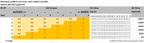

The different sequences simply can be designed in an Excel sheet. Up to now a bunch of about 20 different sequences exists and can be simply selected on each added control unit per tail light cluster.
My currently most preferred setup with a dimmed background:
... and live on my E89:

Yes, I agree.
Unfortunately not. It's indeed handwork and will take some days to reproduce it.
Beginning with the following post from May 2018, you will see the assembling of the external control unit as well as of the "dremeled" cluster:
https://www-zroadster-com.translate.goo ... r_pto=wapp

Well, that sounds easier.
But this solution is able to work as OEM as well as dynamic version. The first option is important for the bi-annually German TUEV, for curious cops as well as in any technical fault situation. There is an implied fall back to OEM, if any issue occurs.
