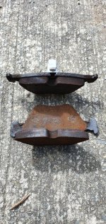

A bit of an extreme case, but last year I had serious judder which turned out to be the friction material detached from the pad backing plate on a nearly new pad.
Also if it helps, years ago my dad had a first generation 7 series and the handbook said you should do several hard stops now and again to maintain the disks and remove any glazing etc. that can occur with gentle use over a period. I guess that is less likely with a Z but it can't hurt !
