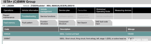

So, had a load of electrical issues due to a dying battery. Changed that out and pretty much everything has resolved itself, bar an intermittent airbag warning.
Used both ISTA+ and INPA to check any issues, printouts attached below. Can delete the fault codes, light switches off. Sometimes it'll come back on when restarting the ignition, sometimes it stays off.
Any ideas?
Any ideas?

first off i would check big yellow plug under passenger seat as some times they come loose. second i would whilst you have the seat all the way forward put you hand under the carpet to see if its wet. if so the it could be roof drain hole blocked and water has ran down inside on to the SBSL unit. this is located under the carpet back corner of cill.

So, turns out the door must have been leaking a while! What started as a bit of an investigation has resulted in removing the seat and pulling all the carpet back in order to dry out the absolutely sodden wet foam under it.
The SBSL shows a little corrosion on the outside, have cleaned it off with isopropyl and there's no obvious shorts on the pcb so will try and see, but I'm aware replacement may well be needed.
