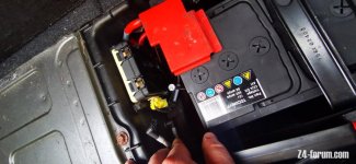

Any idea what this is suppose to be attached to. To be fair it looks like a breather pipe of sorts???
- IMG_20211016_102210.jpg (104.89 KiB) Viewed 174 times

Looks like the breather/venting pipe that slots into the battery

Some E89s were allegedly fitted with non AGM batteries which require a vent hence the tube…
Some AGM batteries do have an emergency vent which uses that tube.
Some AGM batteries don’t have a vent, that can be plumbed, so that pipe becomes redundant
