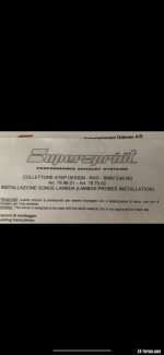

Hi guys
Really hoping someone can help
I recently had my M coupe at CPC engineering for Phil to carry out a host of work - part of which was getting my new supersprint stepped manifold fitted part number 789801 v2
When Phil put engine back in the steering column wouldn’t clear part of the manifold, so VERY reluctantly he had to reinstall the old ones ( at a higher cost to me )
Has anyone had these fitted to a RHD Z4M? When I ordered them they were showing as fitting on a RHD but mine do not fit
I so want them fitted but have hit a road block

Thank you for that
But that is for a V1, mine are v2 which are meant to fit

This shows the repair effected to ensure fit. Perhaps you may have to consider lowering the engine / engine mounts. Whatever, I would be getting in touch with the supplier, perhaps they can offer a solution?
