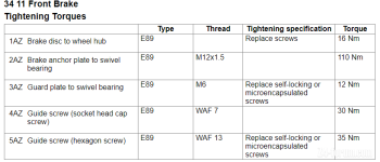

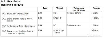

Anyone know what the Torque specs are?

Post by TomK » Sat Aug 14, 2021 8:55 am

Thanks!
