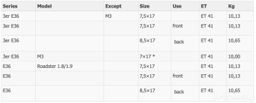

If its a "square" set of 4 x 8.5 et 41 you intend fitting then they will sit & look a treat , zero issues & far better stance than stock rims .
Most sets from factory would be staggered however so beware that the fronts aren't 7.5et41 , they would still fit but better with a 12-15mm spacer to fronts .

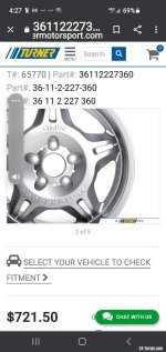

Is the the Mamba M23 Motorsport or BMW e36 M-Contour Style 23 wheels you're talking about?
These Mamba M23... ...or these BMW M-Contour Style 23...

I really like the classic look of the M23 from e36 and z3.
Especially version with "BMW Motorsports" embossed in center. My other goals are "M" steering wheel. Probably keeping suspension stock because "Trac car" isn't good for date nights

So we've clarified that it's 17" BMW Style 23 M-Contour wheels from the e36
