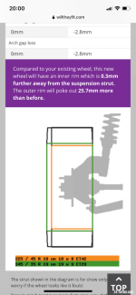

Sorry I’m useless with this, no matter how much I read I can’t get my head around calculating this myself.
Car is stock at the moment but will probably be going down the Bilstein B12 route at some point. Will these wheels fit now and after suspension change? Found a spec sheet on the M2 19” wheels below, someone please help me work this out and possibly give me a dumbed down explanation if you have time.
Thanks
Thanks

Will M2 competition 788M fit E86M?
https://www.willtheyfit.com/index.php?w ... offset2=29
Fronts will poke out more but rolling radius looks very similar and clearance between inside face of the alloys and the strut is unchanged vs stock.
Hang on I'll check rears now

Rears look like an issue in terms of clearance between inner face and strut. They don't 'poke' out of the arches as much as oe in fact, so you may be able to run spacers to get them fitting right.
If you can hang on till the morning I'll run my apex ec-7 specs as a comparison and show you what you can fit - or if you want you can run the numbers :.

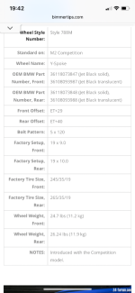

Thanks Ed. I found a “calculator” online and put in the specs. Not quite sure what to make of it though. The fronts say they poke out 25mm further. Worried this will mean it rubs on the arch?Ed Doe wrote: ↑Tue May 18, 2021 10:38 pm https://www.willtheyfit.com/index.php?w ... offset2=29

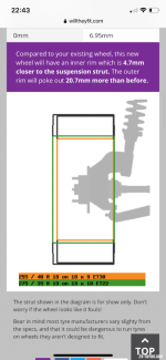

Rears look like they’re very close to the strut but as you said a spacer could solve that but then does that mean it’s going to poke out and rub the arch as well? I’m leaning towards saying no as everyone tends to run 10/12 or 10/15 spacers. My main concern now is once lowered on eibachs is it going to cause a big issue? Front gets lowered by 20mm and rear 10mm.

Ok, so I'm using my wheels as a reference point becuase I know they fit (bear with me here).
I plugged my specs vs OE wheels into the willtheyfit calculator.
My Rears (18 x 10J) poke out 18mm more than stock, and the inner face is 8mm closer to the strut, and they fit fine with minor rolling of the inner lip of the arch. So with the M2 Comp 19s, if you ran a 15mm spacer at the rear, you'd end up with similar overall offset to my rear setup - ie. inner face would then be 7.7mm closer to the strut, and wheel would 'poke' out of the arch 17.7mm more than before. So that should fit but I do think you'd probably need to just get the inner lip of the arch rolled so it's not a sharp edge.
Fronts I think may be the issue.....
My Fronts (10 x 8.5J) poke out 14mm more than stock wheels. The inner face is further away from the strut than stock too (by 0.7mm).
Currently on the road I get (with pretty firm coilovers) no contact between tyre and arch liner, however on track where corner loads are higher, I did notice a bit of rub I think, just behind that stupid fragile bumper clip that always breaks when you try and remove the bumper - so it looks like the tyre is contacting the arch liner a little there under heavy corner loads.
I am currently considering running 10mm spacers but have yet to take the plunge as I'm worried they wont fit, or will rub lots on track....
That being said, I do know in the US with the help of camber adjustable top mounts, and possibly modification/removal of the front arch liners, they do run 9.5j fronts on our cars... Pic below for proof! So it has to be possible, I guess it just boils down to how much you want to muck around modifying the car to make them fit?

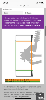

Update which may come in useful for anyone who may consider putting these wheels on in future. A friend who works at a dealership got an M2 Comp in this week, with the 788M wheels I was considering. Had a chance to try them and it won’t work. Rears ware very tight, as Ed said above. Not massively but arches may well need rolling depending on if I lowered I think. Fronts are just not gonna work period.
Looks like I’m going down the CSL path after all. Wanted something different but there isn’t really anything else out there that these cars can sit on that looks as clean & well suited. Found a place called CS wheels in the UK and they do ultra concave 10J rears for the M which should look awesome & the offset allows me to put them on without worrying about spacers. Something I’d ideally like to avoid because I just don’t like using spacers. I just feel like it compromises something somewhere, having a metal plate between wheel and hub just screams stress on the hub/suspension components which must have some sort of an effect on handling in some way (I have limited knowledge so is probably just ocd kicking in).
The setup im now going for on the rear looks like the pic below. Pokes out a couple mm more than the M2 rims but offset is pretty much spot on. Ed you mentioned you’re on coilovers, how much lower than stock are you?

If you used the tyres that come on the M2 wheels, you're right, there's no way.Mos6689 wrote: ↑Thu May 20, 2021 9:25 pm Update which may come in useful for anyone who may consider putting these wheels on in future. A friend who works at a dealership got an M2 Comp in this week, with the 788M wheels I was considering. Had a chance to try them and it won’t work. Rears ware very tight, as Ed said above. Not massively but arches may well need rolling depending on if I lowered I think. Fronts are just not gonna work period.
I've got identical wheels (437M) and they fit lovely on the rear (255/35) and are a bit pokey/stretched on the front (225/35). I'm going to change to 235 on the front which should remove the stretch and am trying to find a machine shop to take 3-5MM off the inside face to make them just right.
That said, they absolutely do fit without rubbing at the moment (I run BC Coilovers slightly lowered with CSL alignment).

Hi Mate,Mos6689 wrote: ↑Thu May 20, 2021 9:25 pm Update which may come in useful for anyone who may consider putting these wheels on in future. A friend who works at a dealership got an M2 Comp in this week, with the 788M wheels I was considering. Had a chance to try them and it won’t work. Rears ware very tight, as Ed said above. Not massively but arches may well need rolling depending on if I lowered I think. Fronts are just not gonna work period.
Sorry didn't see your latest post till just now!
I'm not entirely sure how much lower I am than stock but it's certainly not obscene - there's still plenty of clearance for speed bumps etc. Can't really help beyond that sorry! Pic below if it helps!
Out of interest, fitting spacers does have advantages but also disadvantages - generally they can increase load on the wheel bearings, and on the front modify the scrub radius which can introduce some undesirable handling traits, but correspondingly increasing track does improve grip at the corrseponding axle.
All of this is relative though - if you fitted 10mm spacers I highly doubt you'd notice any distinct negatives, and wouldn't place much additional load on the bearings - I ran 10mm spacers on the front of my 3.0si coupe for years (needed to clear the upgraded brake kit), including on several trackdays and never noticed any negative effects on the handling!

Been banging my head as to how yours doesn’t rub on full lock. I can’t see how camber makes that much of a difference on full lock on the fronts when picturing it in my head. I very well may still not be getting it. Always just bought wheels, matched the stud fitment and chucked them on, never gone this in depth.
Only thing I was just drawn back to is the offset of the alloys, yours is ET35 & mine ET45. I think that 10mm is literally the difference between rubbing and not rubbing. Thinking the only way to stop it, is to use a 5mm spacer on the fronts & hope that’s enough. It’s hard to gauge if 5mm is going to be enough when looking at where it touches. I suppose even if it doesn’t stop the rubbing completely, it’ll still give me more clearance than it currently has. I think going 10mm is going to make the wheel poke out of the arch, because these new wheels already sit a further 14mm out vs the 224’s.
Must admit it I’m starting to regret this tyre size choice. Should’ve gone 245/35 & 275/30. Clearance wouldn’t of been an issue then, front or back. Mind you 275 would’ve had extra poke out of the arch, depending on tyre manufacturer. At the moment the poke on the rears is on the absolute limit of acceptable IMO. new wheels are supposed to be a joyous thing, this is just painful atm!
