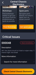

Has anyone came across this error when scanning for errors?
Carly returns a '000048' code under the category of 'Central Chassis Electronics' and this description
'WI1 line short-circuit to U-batt or Wiper Relay 1 / Interior light: line break'
My wipers function correctly and interior lights are fine, I had LED's fitted to the interior but have reverted to stock bulbs but the error returns
after being cleared.
Any help appreciated
