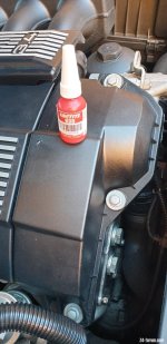

After reading other methods describing the difficulties related to removing the studs holding the Vamos unit, I have decided to take a slightly different approach.
In order to remove these studs easily with a socket wrench I have Locktited the original nuts back on to the ends of the studs.
The area was degreased with break cleaner followed by giving the car a spin to warn up the engine.
Working quickly the nuts were removed, degreased, then finger tightened back onto the studs using Locktite 648.
The nuts were threaded only on the tips of the studs being carefull not to tighten all the way up to the Vanos, Locktite 648 is extremely strong stuff and would be a pain in the butt the nuts welded themselves to the Vanos.
I shall leave everything to set overnight and fingers crossed remove the studs easily tomorrow

Tbh, I found it really simple to lift the engine slightly, but if your way works then it's another approach and I guess it saves faffing about underneath?
Will you have enough clearance to extract the studs? Given that the lack of clearance is at the most 5mm then I reckon the stud should move laterally enough to clear everything.
Only slight issue I can see is lining it all up again properly and making sure the gasket is properly positioned.
(Or are you only using your method on the problem studs?)
Of course, if the Loctite loses it's battle with the studs in the head end then you're a day behind
Good luck. "He who dares Rodders, he who dares...."

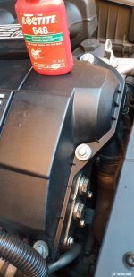

Unfortunately the Locktite 648 had gone past its sell by date and didn't set hard. Not one to give up I am using Locktite 638 (extra strong)
I will update as things progress

I did say I would give my updates, worts and all!
My latest installment (War an Peace) is to report the looktite 638 managed to remove two studs out of six! I do beleive I am battling cold weather. Technical data shows both loctite 648 and 638 works best at 20 degrees +
Plan C (third attempt) is to use two part standard Araldite
I will give this a couple of days due to the cold before attempting stud extraction number 3
