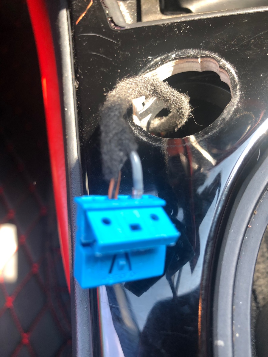

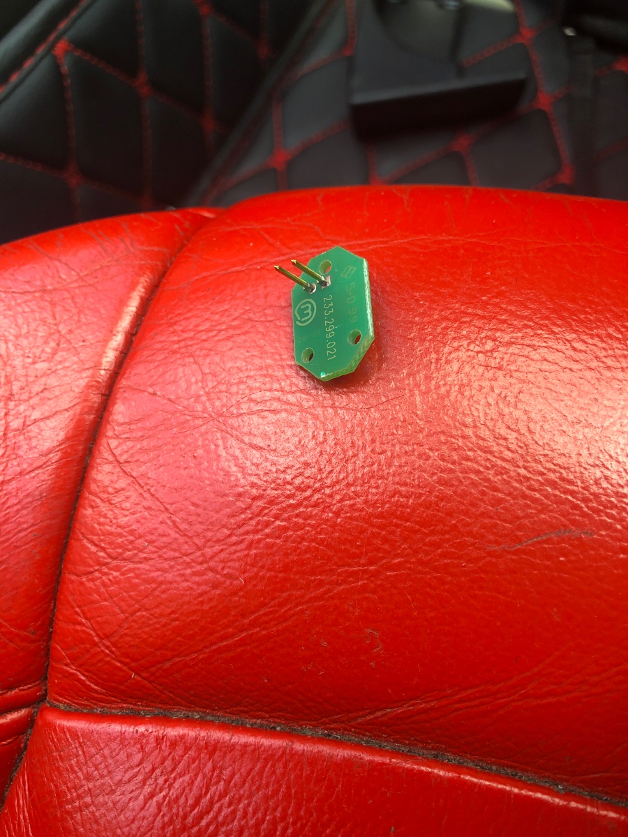

So I got around to this today. I completed the retrofit via ista-p, it said completed successfully, but still my passenger airbag light doesn’t turn on when switch is off.
I’ve tested the led in the light, it’s working (at least, it’s working via a multimeter and glows when testing forward voltage). The switch appears to work also since my c310 correctly changes to on/off as I change switch position.
I’m a little confused as the led has Only 2 pins next to each other , but the plug has 2 pins with a 1 pin spacing. Meaning only 1 pin connects. I’ve tried looking for wiring diagram etc but I just can’t find any explanation!
Any thoughts?

IAmOrion wrote: Fri Jun 26, 2020 12:34 pmSo I got around to this today. I completed the retrofit via ista-p, it said completed successfully, but still my passenger airbag light doesn’t turn on when switch is off.
Any thoughts?

Hi, yeah you are correct both pins should touch a wire, my led looks different to yours but the plug is the same, maybe they did different led configurations for early and later year vehicles. See pics of mine, if you just move one of the wires over I think it should work fine from looking at yours

Ahhhh interesting!! Thanks for the pictures that actually helps a bunch. I did try swapping the wires around but still no joys.Wookster78 wrote: Fri Jun 26, 2020 8:11 pm Hi, yeah you are correct both pins should touch a wire, my led looks different to yours but the plug is the same, maybe they did different led configurations for early and later year vehicles. See pics of mine, if you just move one of the wires over I think it should work fine from looking at yours
I’ll try and find one matching the part number I can see on yours though - it’s diff to the one I have
