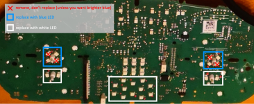

remove old and solder on new LEDs
- further disassemble the cluster as shown in the video, till you get access to the LEDs
- IMPORTANTmark the positives of the LEDs
- turn on the soldering iron, set the heat knob to upright position (12 o'clock) and wait at least 10 minutes, higher temperatures can damage the LEDs
- remove the LEDs, indicated below on the pict, as shown in the video (tip: open the image in a new tab to see it in original size)
- solder on the new LEDs as indicated above on the pict, watch out for the marks you made earlier for the LED positive sides

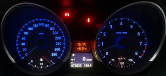

assemble the cluster, put it back and turn on the ignition

I have ordered some SMD LED chips in order to do this mod, whilst I am waiting for those to arrive I removed the cluster today to have a look at the impending job. Those LED chips on the PCB are tiny, I guess you need a steady hand with the soldering iron and a magnifying glass According to some of these videos the SMD LED chips are 3528 / 1210. Is that the type you used? I managed to clean the central LCD screen whilst I had everything apart. Decided to go for all white LEDs including the central LCD as per the video you posted above, might colour the needles red.

I think it would
the LEDs are placed differently, other than that it should work

take the cluster apart and make a photo of the printed circuit, where the LEDs are, no magic hereDr. Zed wrote: ↑Mon Jun 22, 2020 11:41 amI was afraid of that. For those that are gifted in electrics this may seem simple but I am nottintoverano wrote: ↑Mon Jun 22, 2020 11:24 am I think it would
