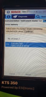

well, a strange thing happened today, the cars been sat pretty much since i posted the last post, it was a nice day so thought id take the missis to work in the z4 even tho the steering is dead, its manageable once you get going
pulled it out the drive and as im on a corner house i pulled it round to the front door went inside and came back out and the steering light had gone and i had steering back for the entire journey, so thought best time to get to my mates with the scanner,.
had the car off and back on and still no lights, so while his scanner was charging we looked at the tracking which was out a bit so sorted that,
got the car off the ramp and the light is back on
scanned the car and it brought a fault code up for the instrument cluster , went in to that and read the codes and it stated open circuit but unknown fault, the system wouldn't let me reset it with the car running but did allow me with the car off and ignition lights on
so cleared that and the light goes straight out, turn't the car off, waited 15 minutes and get the light back on straight away, scanning and clearing that open circuit fault clears the steering light
so now is this indicative of the ribbon cable? it seems an intermittent fault and doesn't sound like an actual break in a wire, is it possible something in the instrument cluster is broken??
surely if there was an actual open circuit the steering wouldn't work, but as long as the ignition isn't turn't off it works

I also have the same error codes. This is so intermittent it's frustrating. Nowadays when it's a bit warmer outside, especially where I live, most of the time the car starts up with fully working power steering, sometimes with the EPS light on sometimes off, but it's just working when it's hot outside.
Though at night when it's cold, it may take up to 15 minutes of idling to get the EPS to work. (no for me)
