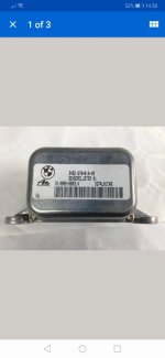

No, the speed sensor is different to the dsc(yaw and acelleration) sensor. The part I replaced was the dsc sensor under the drivers seat. Cost £25 off ebay, part number 34526764018, the face-lift version part no. 3452 6769174 is rare and expensive but the prefacelift one works just fine. I already did the 2 front wheel speed sensors when I rebuilt the hub/knuckle etc. Code 5e38 is the code I had which relates to the yaw sensor not the abs pump or wheel speed sensor. (all tested with inpa and dis v57).

I have a Z4 2009 which has the trifecta problem. My mechanic has removed the YAW sensor code 3452 6769174 and says that it is faulty as it was sitting in a pool of water?! Reading the forum and unable to locate a replacement part (apart from BMW at a cost of circa £500) I purchased part 34526764018 which has been stated as interchangeable. My mechanic has said that there is an ABS light coming up which cant clear. It has a lateral accelerator code - 5E34, My mechanic cant clear – maybe his coding equipment isn’t up to it – his words. Any ideas of what I should now do? Thanks in advance
Good pic - that's the first time I have actually seen what the lateral acceleration / YAW sensor looks like. I guess you have to remove the drivers seat to get to it?
