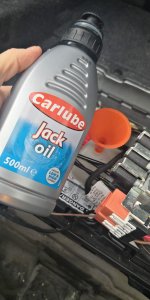

https://www.amazon.co.uk/gp/product/B00 ... UTF8&psc=1
Newbie here - I bought this from Amazon for topping up E89 roof oil. Is this OK? SAE 10W (ISO 32)
Thanks!
Carlube Jack Oil is a high quality hydraulic oil which has been specially formulated to provide smooth operation of hydraulic jacks, both trolley and bottle types.

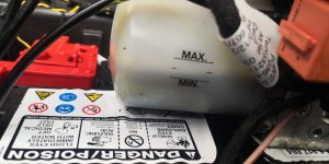

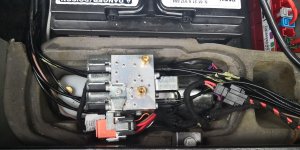

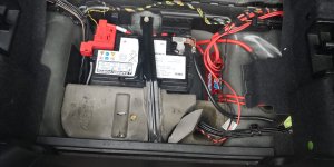

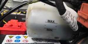

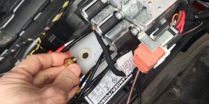

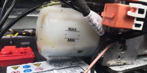

hydraulic roof motor fluid
Managed to do it. 2 min job.
Unscrew battery retainer bar.
Lift out pump.
Photo shows level the oil was at.
Remove filling screw on top of reservoir
Top up with oil - I used this from Amazon £6.
New oil level.
Noted that it had been leaking from the bottom of the pump (possibly from loose jubilee clip holding reservoir onto pump, through foam and into tray underneath.
Open and closed the roof, noted that it had drawn fluid into the system (level had dropped a bit).
I'll keep an eye on it and top up if required.
Hope this is helpful!
