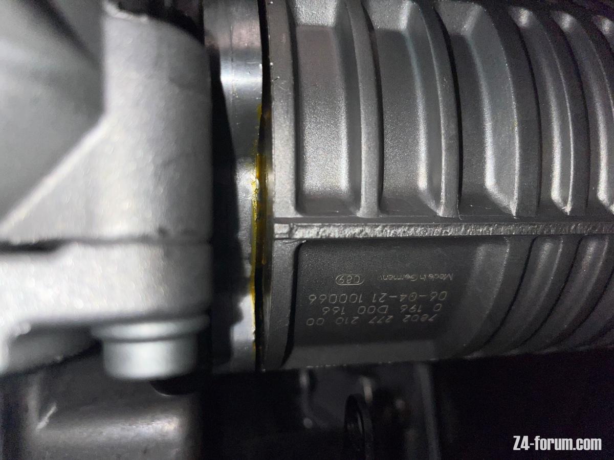

Post by Emanresu » Mon Feb 19, 2024 3:06 pm
So I went to do this as my steering feels a bit odd at motorway speeds. Sort of constantly sticking/unsticking, only ever so slightly but just constantly adjusting like it’s catching a magnet on/off.
I managed to undo the torx bolts no issue, however the ring seemed to be seized in place? The hole that people were using to put a screw driver was completely inaccessible as it was up in the 2 o'clock position, does this mean it’s already been fully adjusted?
If so, would I need a new rack to fix the issue?

Post by enuff_zed » Mon Feb 19, 2024 3:15 pm
Emanresu wrote: Mon Feb 19, 2024 3:06 pm So I went to do this as my steering feels a bit odd at motorway speeds. Sort of constantly sticking/unsticking, only ever so slightly but just constantly adjusting like it’s catching a magnet on/off.
That does sound as though it's at its full travel. Just checked on the one laying in my garage. They usually have a good 10mm of open slot showing past the bolt, which equates to at least 20mm of adjustment left.
However, before you get too deep into it, there is a possibility it has been adjusted too far in the past. There is a sweet spot either side of which you start to get odd behaviour.
So you could try moving it back. Mark a datum line across it before you move it, then pull the bottom of the ring back towards you until you have a good 25mm gap between the datum marks. It will likely be too far, but it will allow you to then tweak back 5mm at a time to see if it improves.
It's so easy to adjust, if you leave the panels off you can go for a drive and do several adjustments as you go.

Post by Emanresu » Mon Feb 19, 2024 3:24 pm
enuff_zed wrote: Mon Feb 19, 2024 3:15 pm
Thanks for the speedy reply!
When I had the bolts loosened, I tried to adjust either way and the ring was completed solid, I could rock the entire motor a few mm but the ring would not slide? I managed to prise the bolt from the connector in case it just needed the seal broken, didn’t change anything.
This is viewed from the bottom.

Post by enuff_zed » Mon Feb 19, 2024 3:31 pm
Emanresu wrote: Mon Feb 19, 2024 3:24 pm
Hmmm. OK, well the motor is bolted directly to the column so you can't mess that up.
I would try a couple of turns on the bolts so you can move the motor over a little, then try tapping a thin blade between the column and the spacer. It must be just sticking.

Post by Emanresu » Mon Feb 19, 2024 5:07 pm
enuff_zed wrote: Mon Feb 19, 2024 3:31 pm
I don’t know what voodo you did mate, but I thought I’d give it another crack after you said, so I loosened it as before and straight away it adjusted freely 😂 so just going through adjustments, then a quick drive, adjust etc to get it perfect! Thanks for your help 👍
