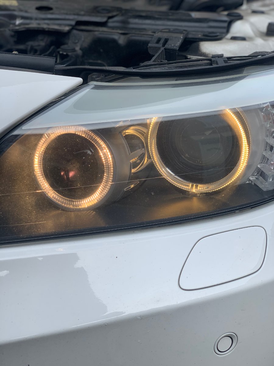

So I've just done my Lil update from standard yellow to led. My angel eyes are coded to maximum brightness as a lil background info.
purchased https://www.aliexpress.com/item/3287351 ... 4c4dTsdNlB - installation was a bit of a mess, the size of the led meant that I had to do some sorcery with trying to get them in, then turning them to lock was even more painful. I've cut open my hand but anyways - installation was havoc. now for the results.
noticed one thing - After installation, I went to test the led, left it on for like probably 5-10 mins whilst I was on the phone. Came back to sort out the resistor and the cables and boom! burnt my hand on the resistor was super hot. Sure enough, it's normal but got me worried about touching the OEM wires and causing any issues so I've plugged them managed to house them safely.
so really not very happy with the results, If anyone could recommend me better angel eyes without breaking the bank that would be much appreciated.

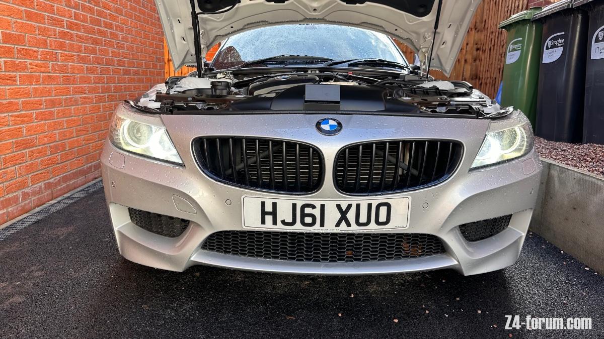

Post by Reamesy » Sun May 26, 2024 5:42 pm
Amazon link
£49.99
NOVSIGHT H11 H8 H9 LED Headlight... https://www.amazon.co.uk/dp/B07S295L4T? ... b_ap_share

Inside the fitting the bulb sits in the is a reflector to focus light onto a small mirror that reflects light into the light guide for the rings.
Try led bulb which has leds at the top pointing out.
Square plate with dimple has a mirror (purple colour is back of mirror) attached to focus light along the guide.
From memory this is with novasight bulb fitted.
