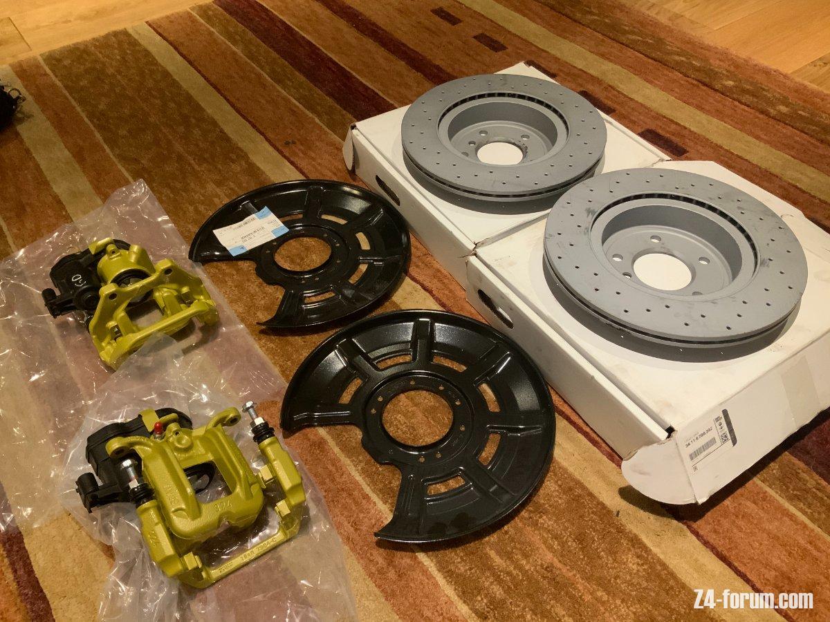

Just wanted to update those desperate to know so that we can close off this matter..
I ended up making my own mistake of buying some US spec 35i rear brake calipers, then expensively refurbished only to discover US spec 35i have the same rear discs as all other smaller models...
So..2nd attempt..bought 3 parts (one new, two breakers) to build a set of 35is spec rear calipers..
Loving (and expensively) re-furbished by Bigg Red..back today..
Being mated with some lovely vented and drilled OE quality Zimmerman rear discs 324 by 20 vs 300 by 20
So next week being fitted to complete the BBK odessy..
Don't think 24mm extra disc and a revised rear caliper is going to make a world of difference but..we'll see
