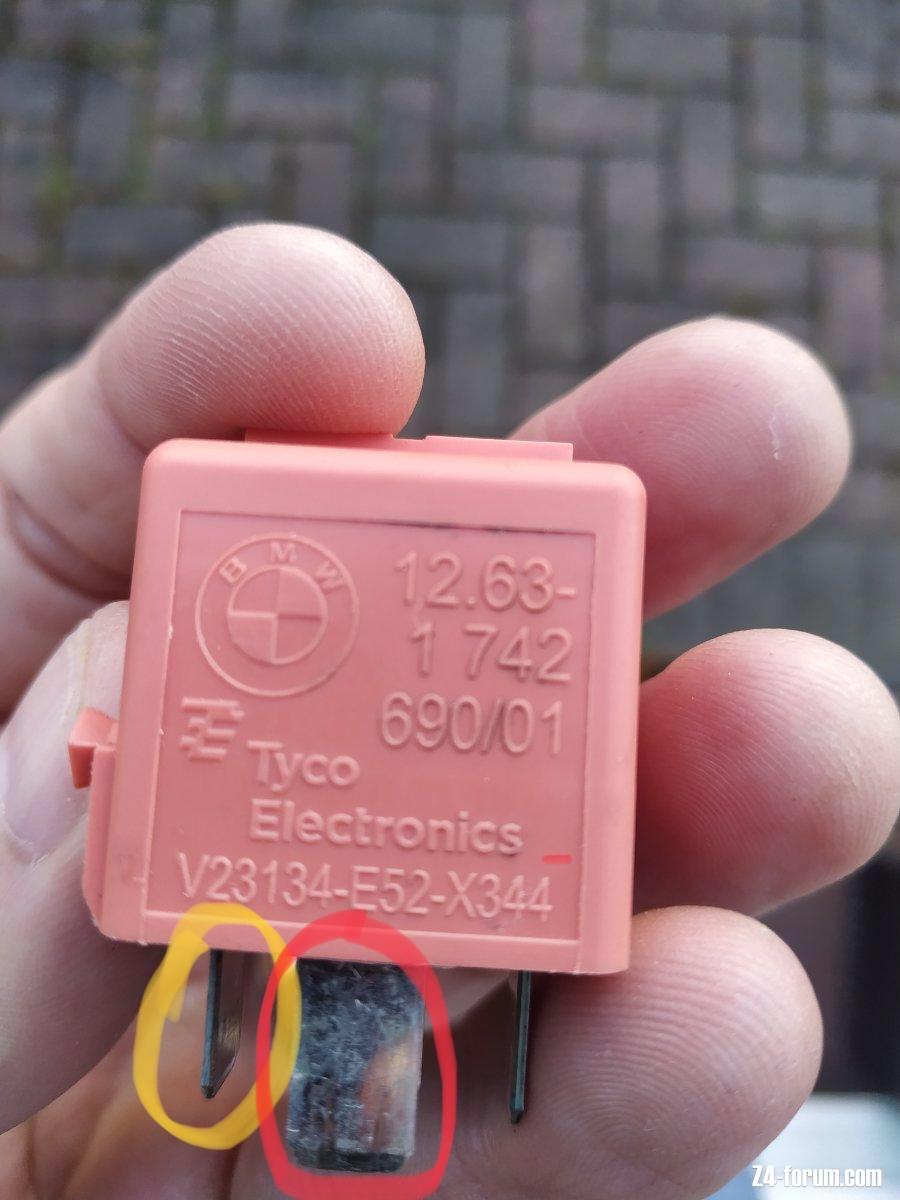

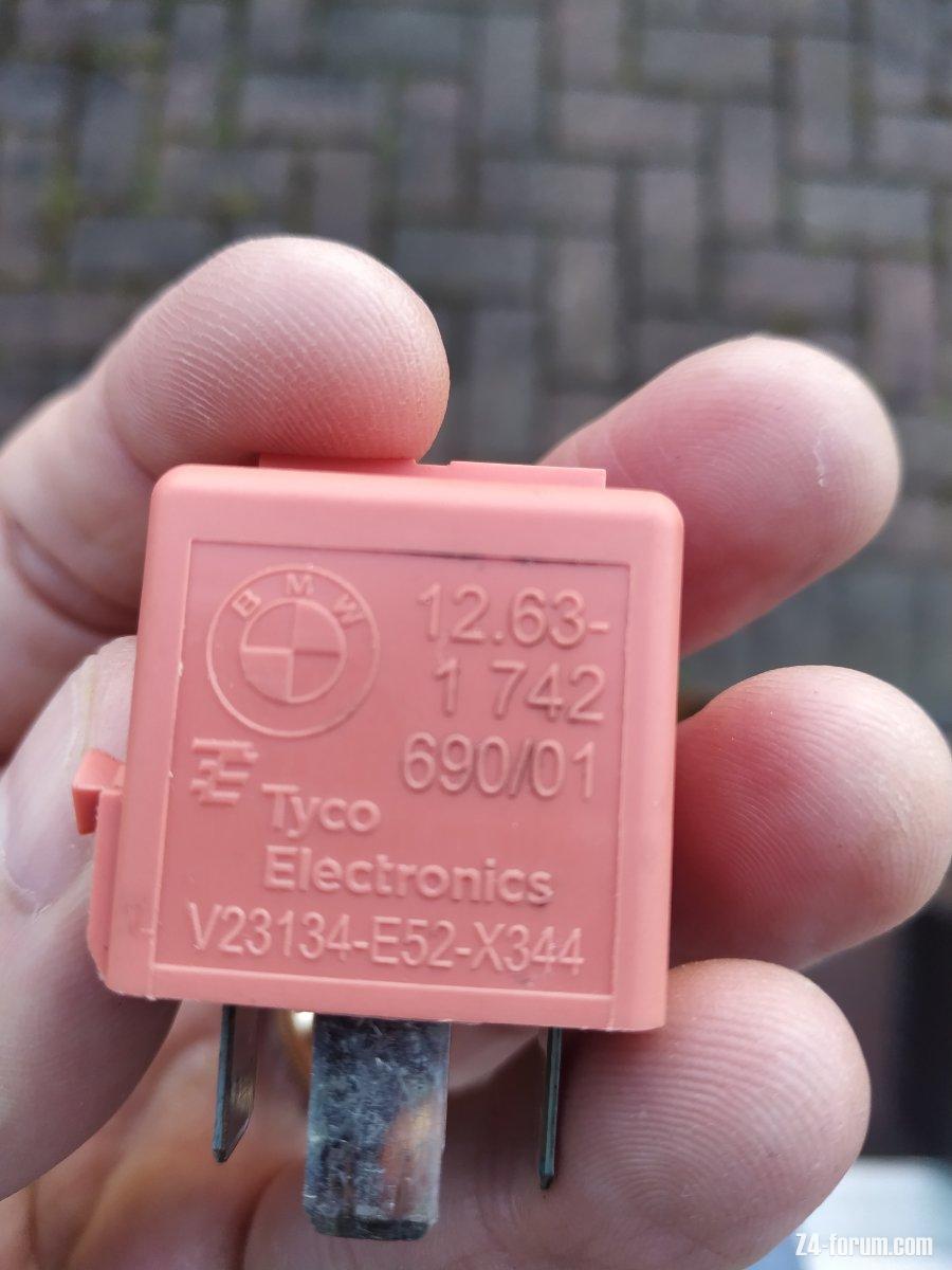

Hi guys, took a relay out to see how old they are. Can you see a date on my relay?

2014 Wk35

One of those connectors looks burnt?

I think the connectors were reflecting my dark jersey, they were pretty clean. They'll get swapped out anyhow.

Stash36 wrote: Wed Sep 30, 2020 6:18 pm I think the connectors were reflecting my dark jersey, they were pretty clean. They'll get swapped out anyhow.
The red circle terminal looks burnt and rough compared to the yellow shiny and smooth one.
If it is burnt it may be worth checking the plastic connector block that terminal goes into to make sure it’s not damaged :thumbsup:
