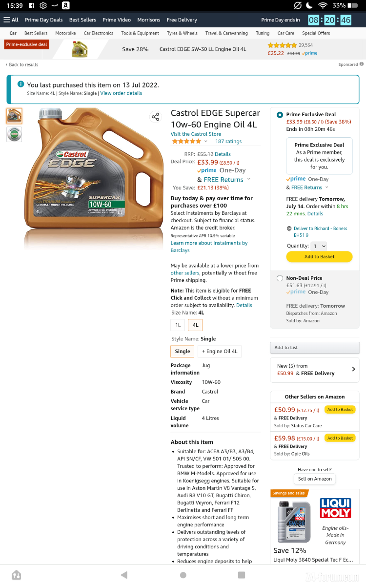

Post by MefiEcosse » Wed Jul 13, 2022 3:43 pm
Old thread but if you want 10-60 it's a great price at Amazon today.
