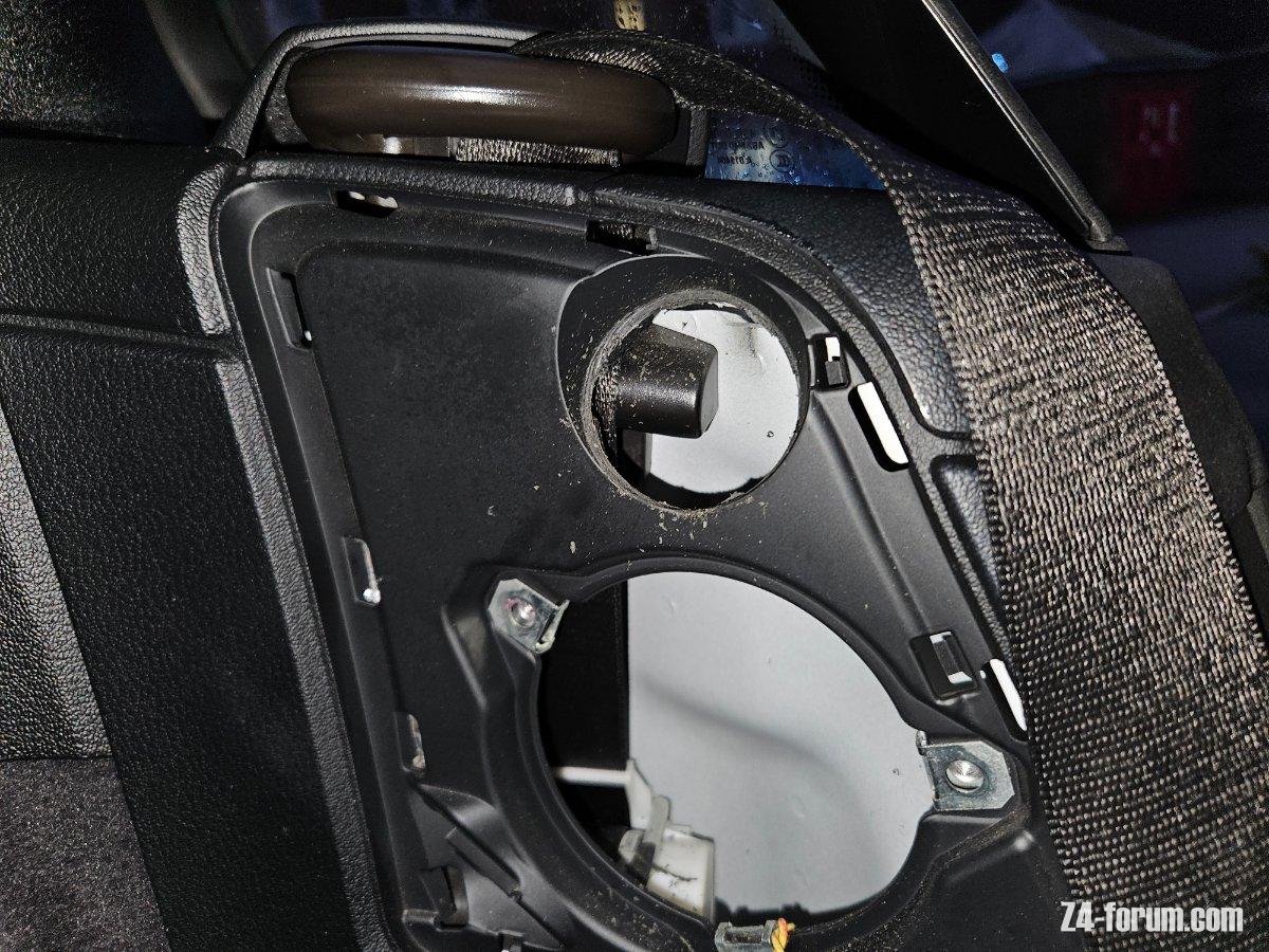

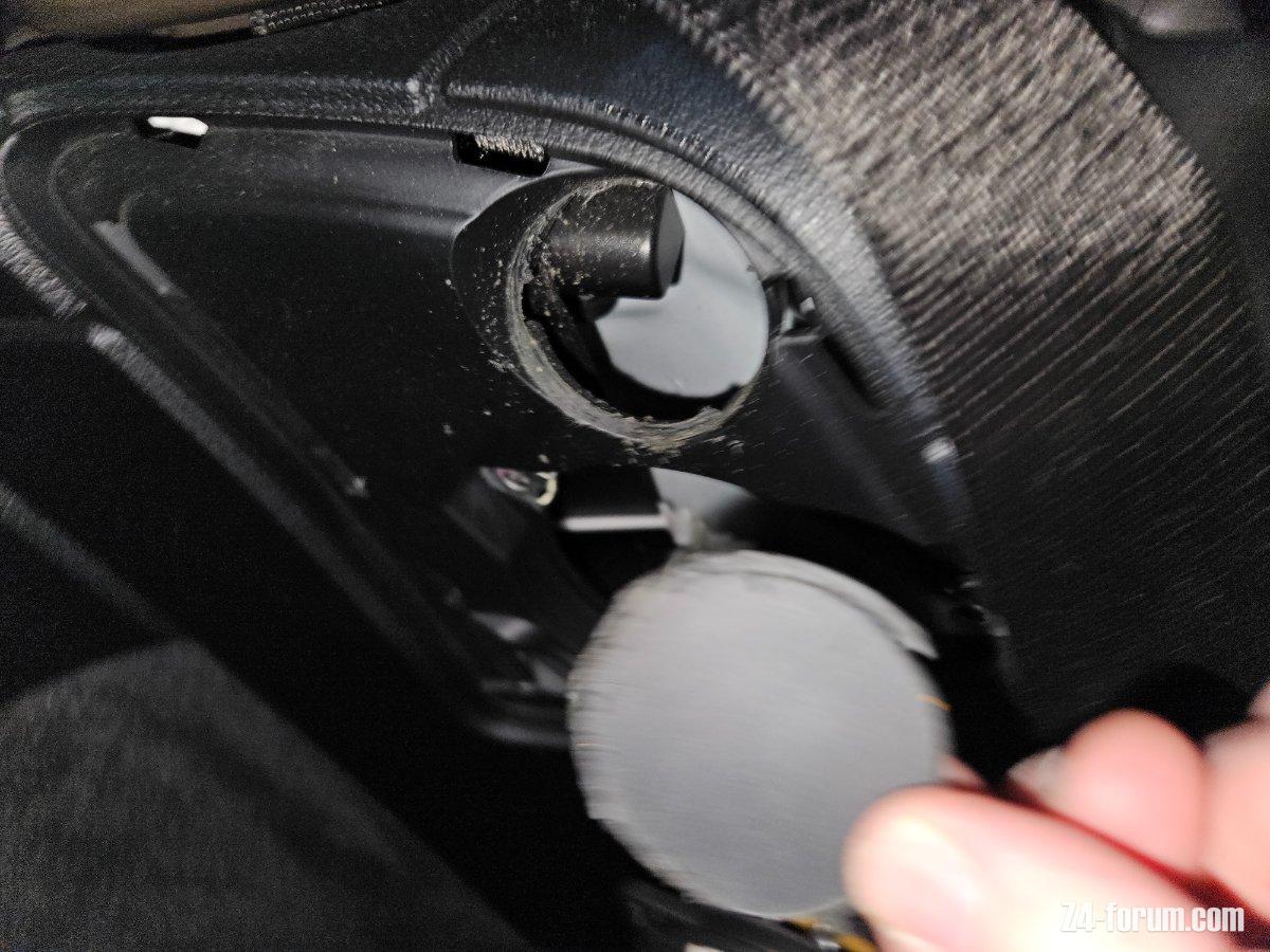

In case helpful to anyone, attached are photos of the holes I drilled to add tweeters to the rear mids on the base system - it was super easy using the circular drill bit at a slow speed and holds it quite snugly.
