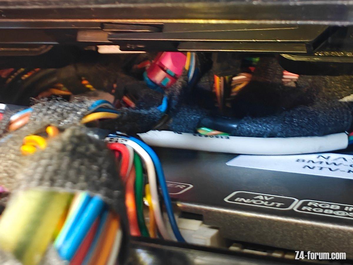

Don't know if I stumbled upon the issue here. Insight could be helpful
I found this device once I took off the client control panel
Looks to be possiblity aftermarket? I'm assuming maybe for the backup camera?
If anyone knows if I could somehow get this working with the mr12volt would be appreciated 😀

More photos

Looks like you have the optional BMW TV unit…I sssune..never seen one…who knows how /if that interferes with the Mr 12 Volt ?

Definitely aftermarket.
Difficult to say for certain, or even how it's connected. Personally I'd look at ripping it out, but after checking where/how it's connected. You'd still get your camera input through the Mr12volt, so no biggy it removing it. :thumbsup:

Yeah I ripped it out, but the job who ever did this... I have two leftover plugs from the rear camera looks to be female banana plug for video and power/ground just don't know what to ground to
Other than rear camera not working the mr12volt does so I'm much happier to sacrifice the camera for now or look into a better camera

Envain wrote: Sun Sep 29, 2024 8:31 pm Image
So the yellow one, as you say, is the video feed. this should just plug straight into the appropriate Female one on the Mr12volt end. As for the power supply I now recommend not bothering to run a power supply through the car, but instead fit one of these filters...
Link... https://www.amazon.co.uk/dp/B0CZ8M4JCP/ ... _lig_dp_it
(Yes I appreciate it's a UK link, but at least you can get the info for a US supplier)
With this you can just tap into the reverse light feed and the a local negative in the trunk area to power the camera. Normally when you tap into the reverse light for power it can create a flickering on the screen, but with this filter that smooths the power out to give a steady image :thumbsup:
I also highly recommend a centrally mounted camera, so not one that is built into the license plate light.
I'm currently using one of these, it just sticks behind the license plate...
https://www.amazon.co.uk/dp/B016ML1ORS/ ... _lig_dp_it

I found those parts on the US side so going to try that in a few weeks. Very helpful thank you.
Is the mic not integrated into the cables from the back of the HU? I might have missed something about the Mic connection and doesn't seem like it's picking up.
