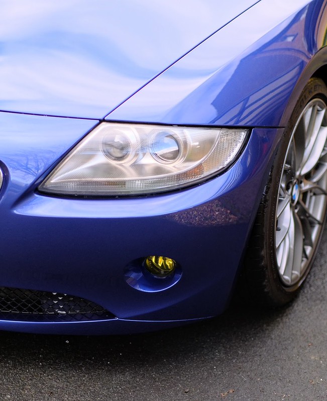

Headlight polish time:
These have come up really well after using the Quixx Headlight Restoration Kit.
The lens caps had a bad case of sunburn, rough to the touch and just looked a state.
30mins of wet sanding, polishing and sealing and they're good as new.

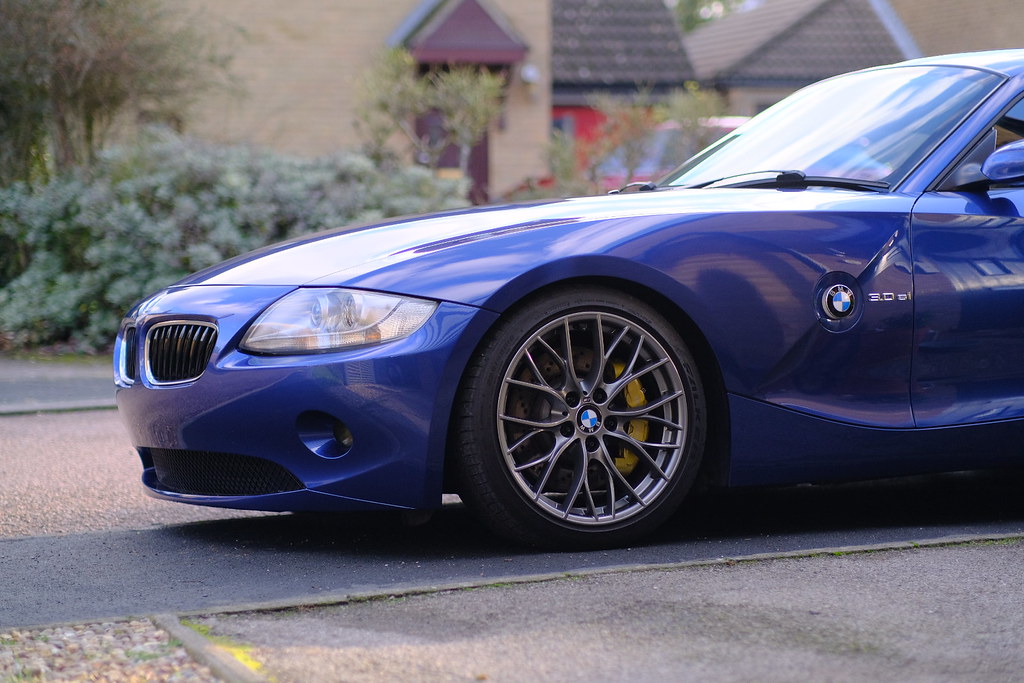

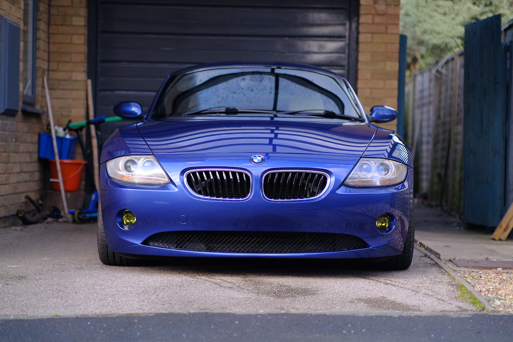

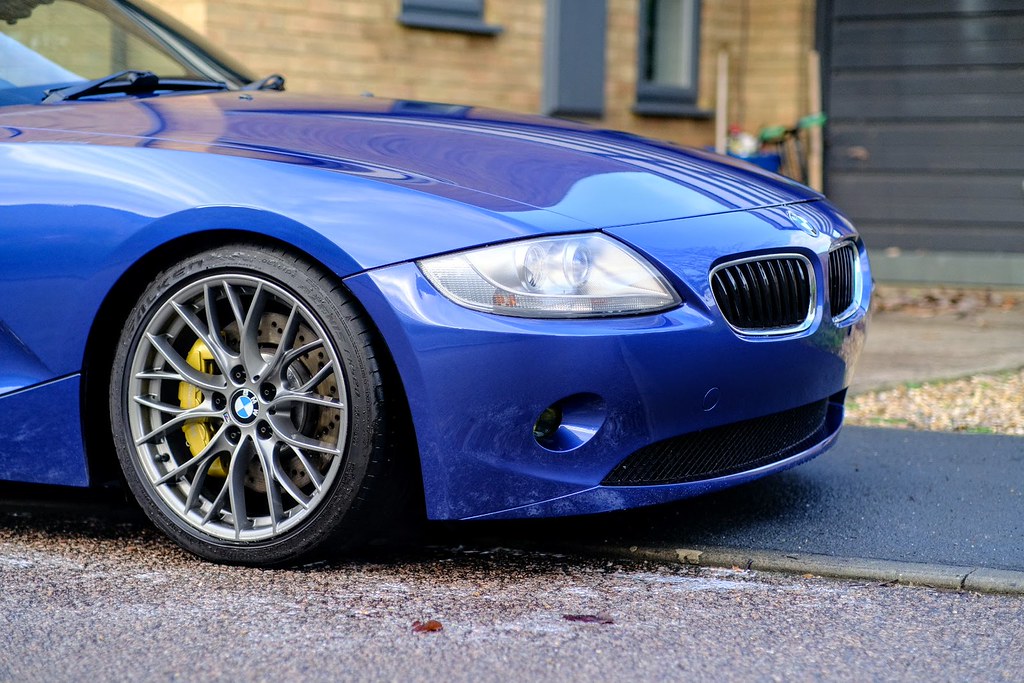

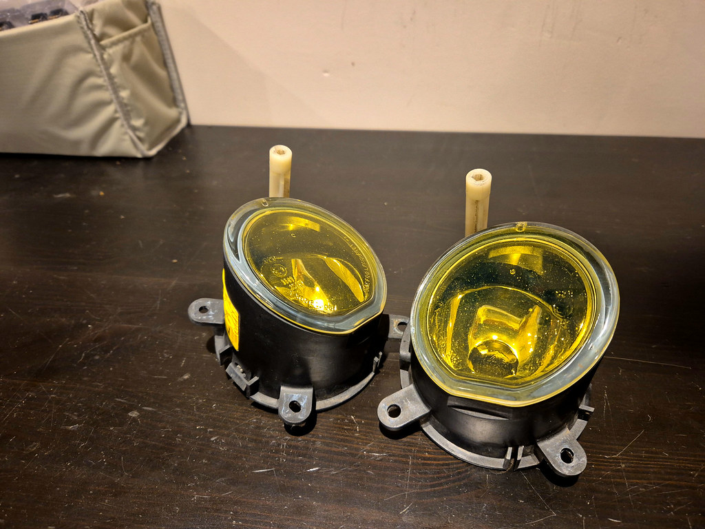

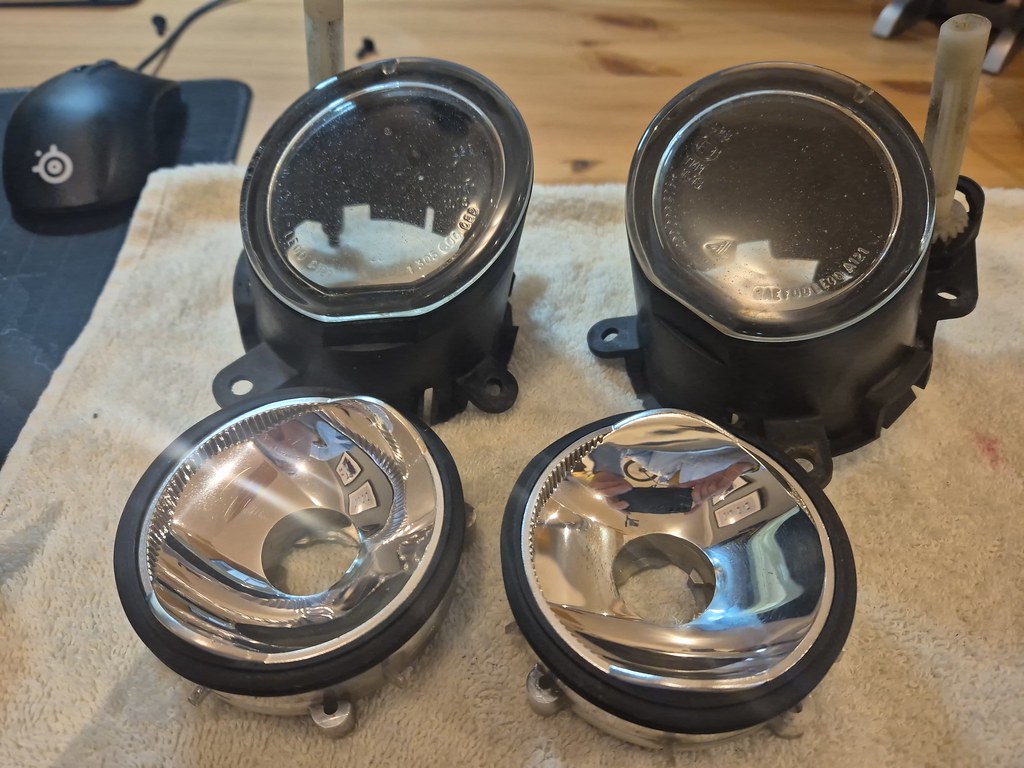

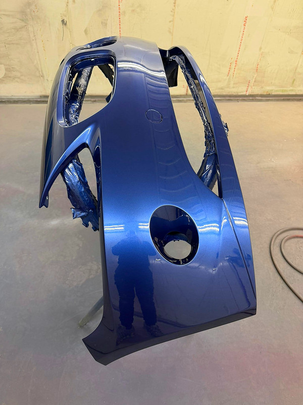

Meds 3.0si Coupe - Update: BBK and fog light removal
The front drivers fog light was pretending to be a fish tank so, I removed it to clean up and drill some holes in the underside, hopefully limiting the amount of condensation in the future. It's no surprise they fill up with water. Inside the bumper it's really wet and the fog lights sit below the headlight that has a large gap between it and the bumper.
Until I either find a replacement, paint them Montego Blue or find some blanking plates.
The car port is finsihed, now she can stay dry. Ready fo me to tackle 2 jobs.
Front bumper removal to get both headlights out for a proper refurb.
Rear drivers wing so deliver it to my local bodyshop for a tidy up.

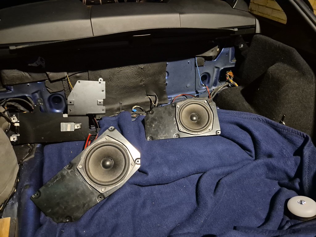

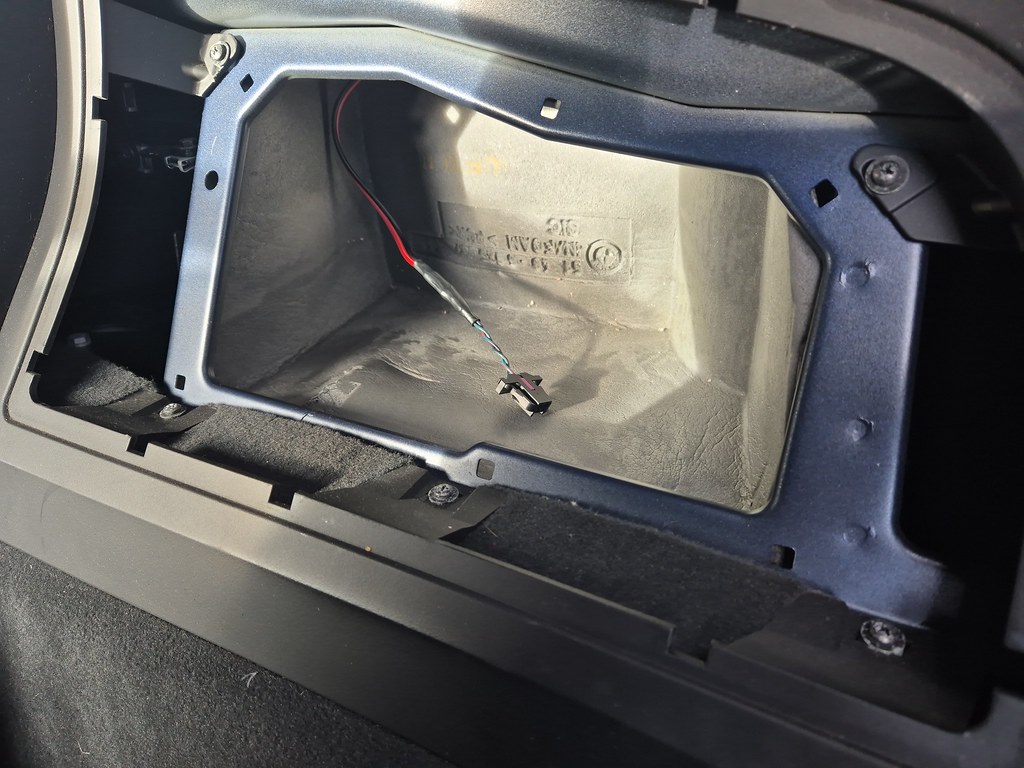

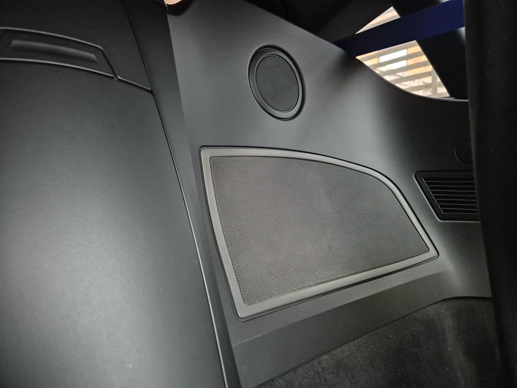

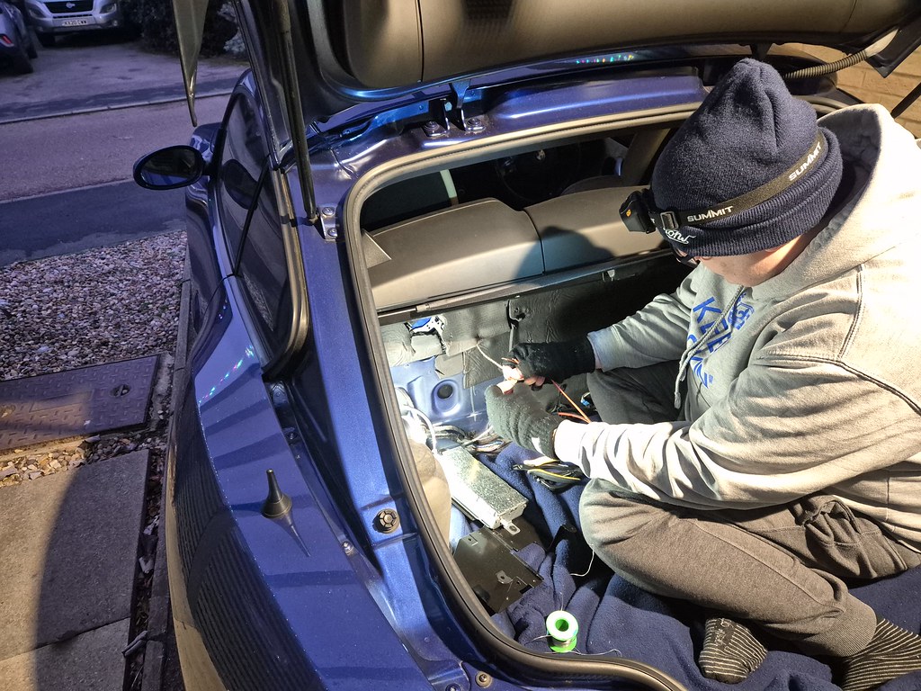

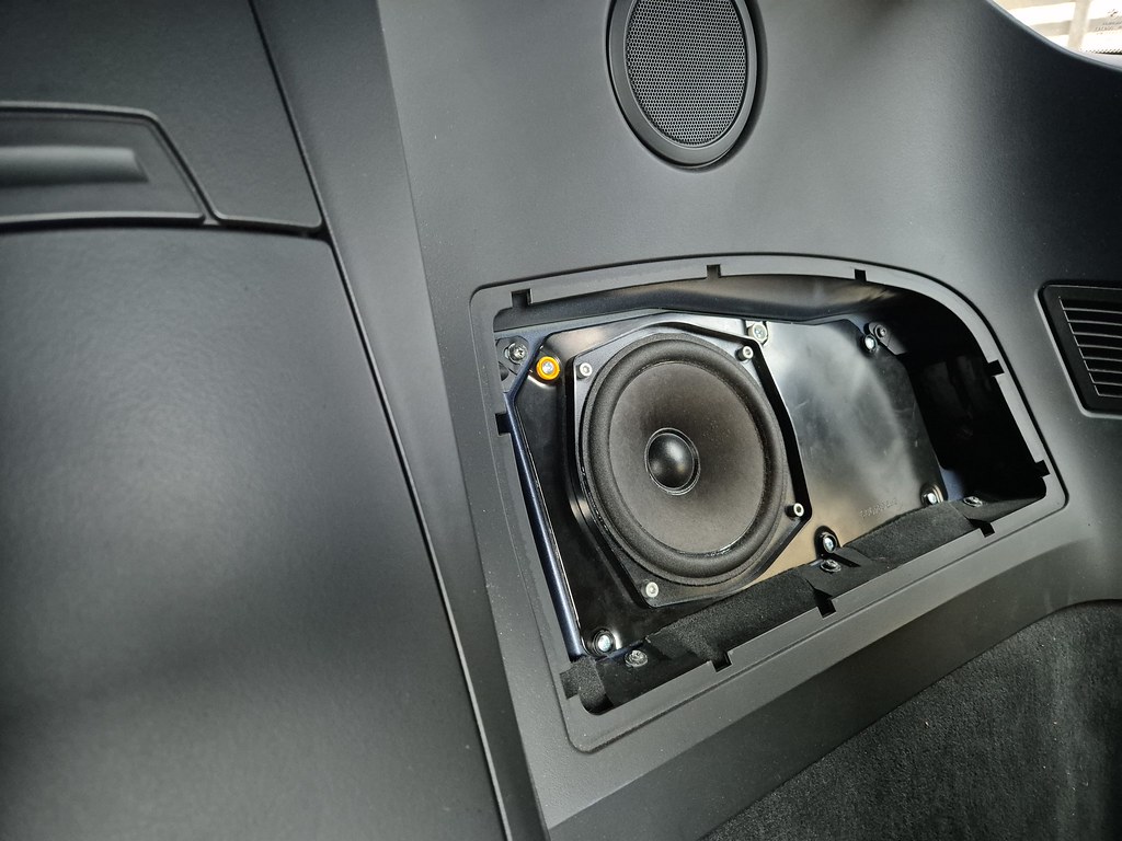

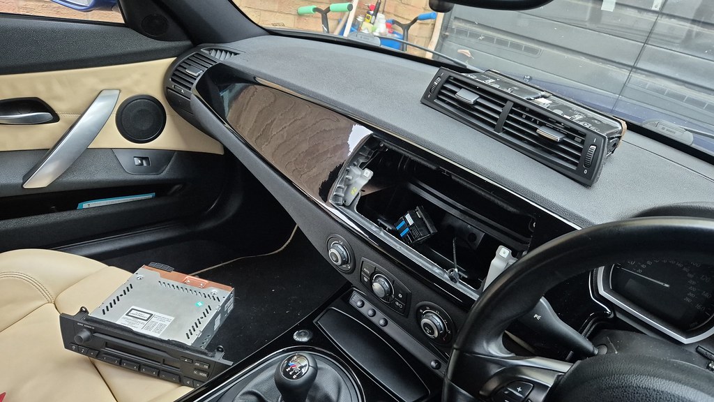

Project sound insulation a go go!
Surprisingly, the rear strut towers have insulation, as does some of the rear carpets and the carpet along the rear bulkhead. The nearside void behind the passenger shoulder had a little but I've added loads more.
The drivers side void is empty and I suspect this causes a load of resonance.
I've pretty much stuck the insulation to everywhere with a gap.
So far:
Underneath the 2 cubby holes with nets.
All the rear plastics.
The voids behind your shoulders.
In the empy space above the rear wheels towards the cabin, up towards the rear windows.
The floor between the battery and bulkhead.
The rear bulkhead.
The underside of the battery cover.
Carpets out:
Underside of plastics, done:
Drivers side void, empy:
Left to do:
Inside the boot lid.
Stuff a load of bubble wrap or foam to fill up the voids behind your shoulders.
The plastics on top of the rear bulkhead. (anyone know how to get into these?)
So far:
The rear bulkhead.
Carpets out:
Left to do:

Meds 3.0si Coupe
Nice job!
The central sections up top simply pulls out (clips only). Then the two sections directly behind the driver are secured underneath the seat belt guides. Pry off the rear cover on the belt exit “bump”, remove the Torx and lift out.
