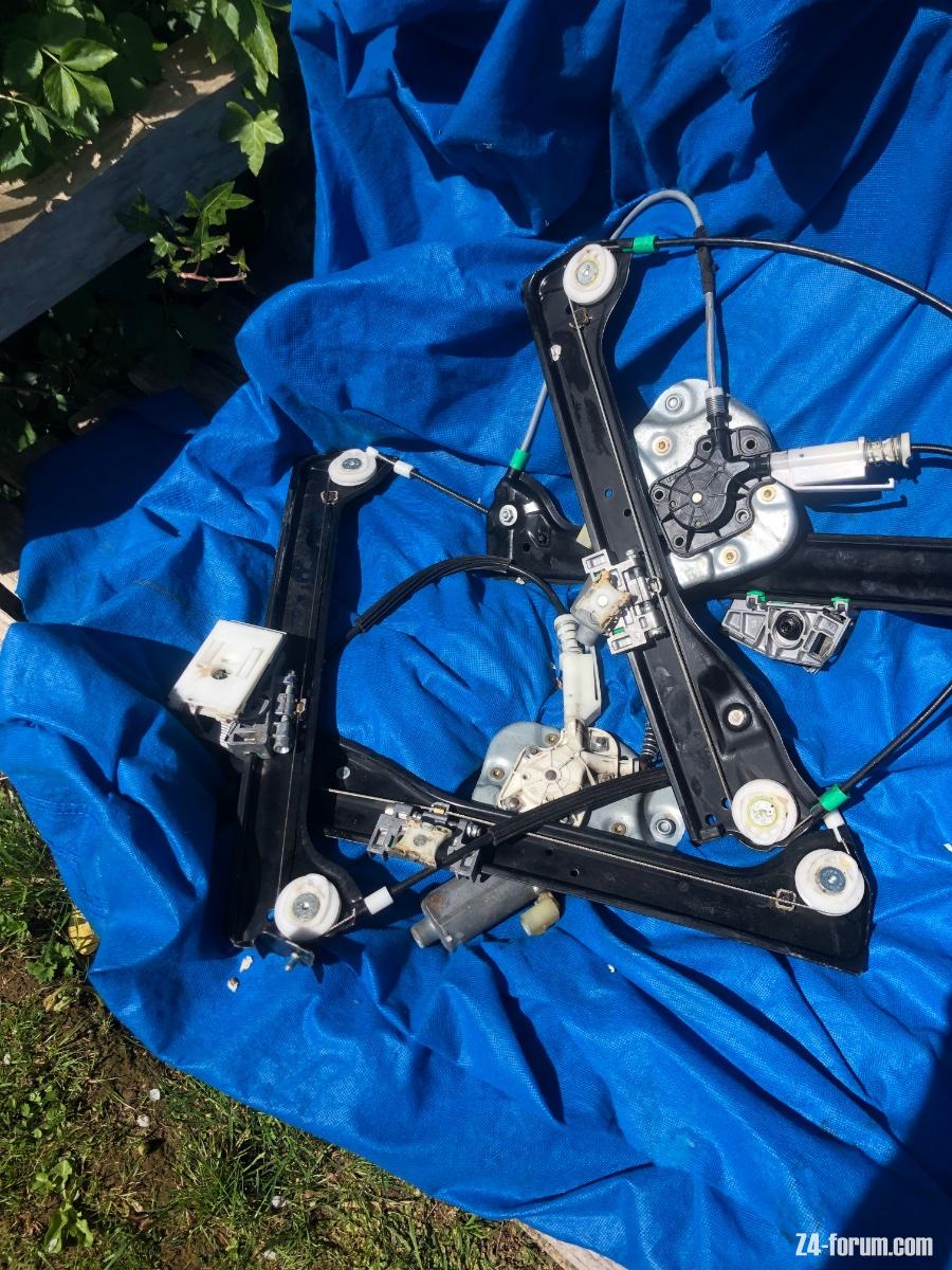

Post by Tango22 » Thu May 01, 2025 5:40 pm
Umfaan wrote: Thu May 01, 2025 4:51 pm I have. Window regulator mechanisms available.
Both sides
What year is you car ?
Hi, many thanks for that but I think I'll just book it into my local Indy and have them do it. From a few of the YouTube videos I've watched it looks like a complete pain of a job which I'm not really up for tackling myself!!!
